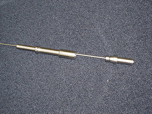

If your using the thru-the-timing cover style Milodon makes a real nice stainless steel one with rubber O-rings (MIL-22040) Which you can get at Summit or Jegs. If your using this type of timing cover you can see a picture of it in my gallery both in the cover and before I installed it. Btw it works great with road race front sump oil pans.
77Eliminator 03-12-2005 11:16 PM
I checked out summit and jegs site but the picture looks like a flex type tube that hooks up to the pan. How do you mount it to the timing cover? Does it pressed in or is it threaded, do you use the braided tube? My current tube is threaded check out my pic's
KrAzEcJ 03-13-2005 06:27 AM
http://www.clubcobra.com/photopost/d...pstickopen.JPG
Its not braided, its straight stainless steel and is press in not threaded.From your picture I can see that you do not have a stock timing cover but if shaft size is the same it should work.
