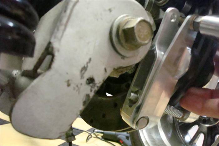

priobe 11-17-2009 10:21 AM
Yes that is the setup I am going with. I tried putting the ebrake setup but the lever that engages the caliper is hitting the rear knuckle.
http://www.clubcobra.com/photopost/d...399_Large_.JPG
http://www.clubcobra.com/photopost/d...398_Large_.JPG
I will contact Kirkham to see if they can work we me on the minor modifiction. I am going to propose that the remake the level to engage up rather than down.
I hope this will not be too expensive because the caliper looks like it will perform very well.
LMH 11-17-2009 03:49 PM
I see what you mean.
Is that a T-bird knuckle? Looks like mine.
