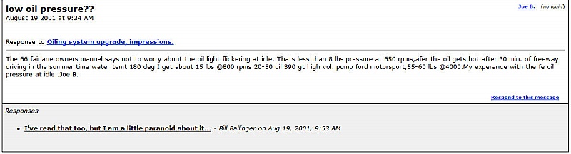

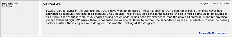

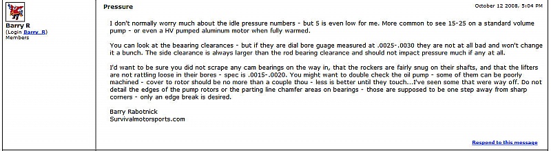

... a medley of some of my favorite FE oil pressure quotes:
http://www.clubcobra.com/photopost/d...ilquote001.jpg http://www.clubcobra.com/photopost/d...ilquote002.jpg http://www.clubcobra.com/photopost/d...ilquote003.jpg |
Your oil pressure is perfect. Lighter weight oil is better, stick with the 10w30. Oil pressure is just that, it is not flowrate. If you had oil pressure of 500 psig and 10 psig the flowrate would be identicle. Your oil pump is a positive displacement pump. It is the small bearing clearances that generate the back pressure on the pump. I have had a boat for 15 years with 6psig at idle and beat the sheet out of it, runs perfect after 3000 hours of abuse.
