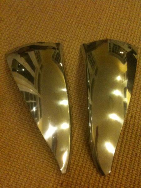

dcdoug 09-22-2010 05:59 PM
Here's a pic of the spats:

Doug, I am looking at purchasing some of these spats for my FFR Cobra. What gauge aluminum are they made of? Can they easily be modified with a good pair of snips or do you think it would be something a machine shop would need to take care of.
dcdoug 10-21-2010 05:54 AM
It's about 1/16" think, so I doubt you can cut it with snips. I still haven't trimmed mine yet, but plan to make a cardboard pattern and then have a friend cut it to size (I don't trust myself not to make it look crappy).
