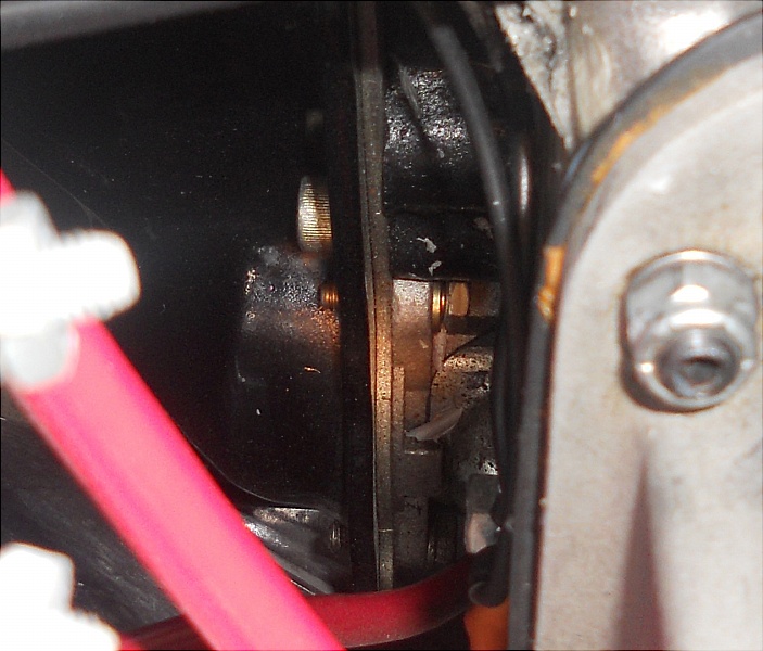

My overpriced Centerforce aluminum flywheel had no dowels -- loctited ARP shouldered bolts though. I do use the split lock washers on the starter motor and, as you can see from the photo, I have to retighten them ever few months.
