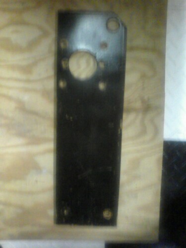

EarlsflyinCobra 01-01-2011 07:57 PM
Here are some pictures..........hope this helps!
http://www.clubcobra.com/photopost/d...bs/plate11.jpg

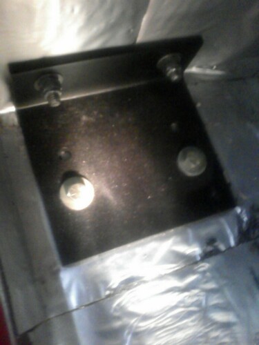

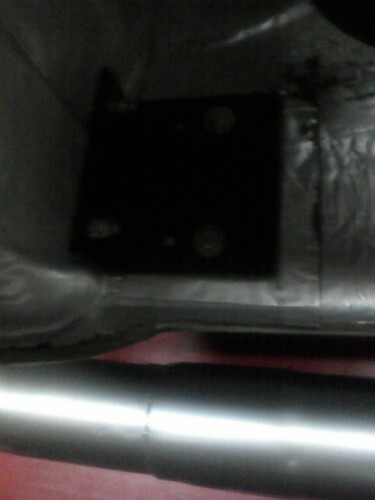

EarlsflyinCobra 01-01-2011 07:59 PM
Pic #2
This plate is attached to the frame on the inside of the firewall and the plate in previous picture attachs to it and is on the outside of the firewall.....
http://www.clubcobra.com/photopost/d...bs/plate21.jpg
http://www.clubcobra.com/photopost/d...bs/plate23.jpg
A better picture..............
EarlsflyinCobra 01-01-2011 08:00 PM

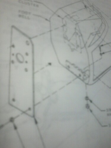

Pic #3 & 4 shows the plate on the plans
http://www.clubcobra.com/photopost/d...mbs/plate4.jpg
http://www.clubcobra.com/photopost/d...bs/plate31.jpg
The pedal box attaches to the top of the plate on the inside and the master cylinder attaches on the outside, in the 4 holes surrounding the large hole.

holt8137 01-01-2011 08:35 PM
I absolutely do not have either of those plates. I do not think the plate you are willing to part with would work with my master cylinder setup. That lookes like it's for one big cylinder. Where as I've got 3 smaller ones in a row: clutch, front brakes, rear brakes.
If you refer to that crappy drawing, on the first page of this thread, that I made of the 1/16th inch plate I currently have, you can get an idea of how they are mounted. The plate you've got just isn't wide enough. However, I am still very greatful for your offer. Good group of guys around these forums.
I took a peek at the rest of the pictures in your Photo Gallery. The pictures of your bare frame from 2003 are very telling. Now I'm fairly certain my car is indeed a SB.
