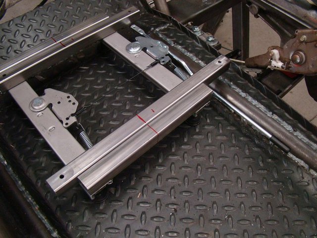

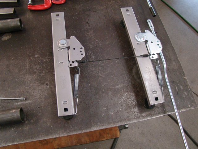

Sliding was my choice...
Seat sliders from Speedway ($16 on sale)
http://photos.imageevent.com/germanp...m_DSC06597.jpg
60 inches of 1x1 inch tubing
http://photos.imageevent.com/germanp...m_DSC06599.jpg
G-Pete 11-07-2011 08:06 AM
mounted on the bucket
http://photos.imageevent.com/germanp...m_DSC06608.jpg
the seat sits on the stud protectors (black). The studs makes it possible the change the lean angle.
http://photos.imageevent.com/germanp...m_DSC06609.jpg
