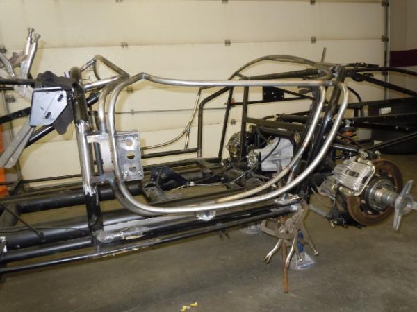

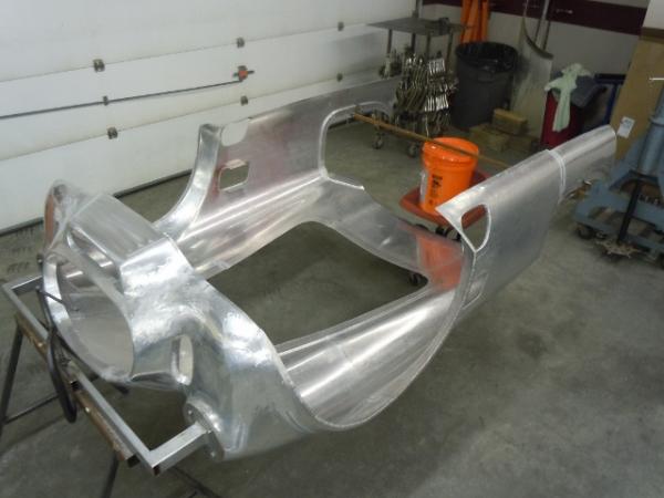

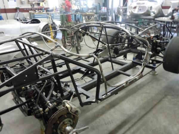

It's been a long time since my last posting, but I've been busy nontheless. After completion of the front and rear body clips, the owner decided he wanted to change the body style from the SC to the Street Version. This meant welding up the holes in the front fenders for headers, removing the SC flares and repositioning the landing for fuel filler cap. All of the super structure has been built up and welded into place. The later 4000 series cars had some modifications made in the chassie which didn't allow the insertion of the jigs necessary to create the secondary structure that holds the body. This required some slight adjustments to tooling for proper fit. Additionally, the later cars used a two piece hinge system that allowed for adjust-ability in all four directions. Great idea for fiberglass, but a "no go" for aluminum. It was necessary to fabricate the traditional style hinge box and cut away the updated version so that they could be welded in place on the scuttle support. Also too, all frames for hood, trunk, and doors have been fabricated and function as intended.

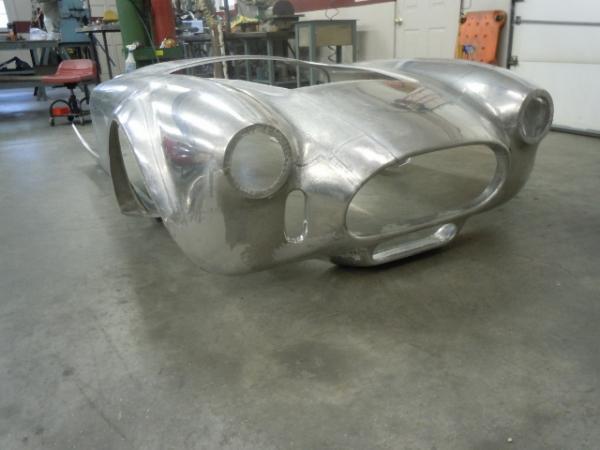

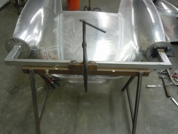

Before any of the individual operating panels can be mounted and skinned, all of the body sheet metal needs to be wrapped around the tubular super structure. This is very labor intensive and requires LOTS of hammering. When all of this is completed the first panels to be skinned and fitted are the doors. The reason for this is the shape of the front fenders begins in the doors. Once the doors are in place and operating the final planishing and finishing of the front fenders can begin.

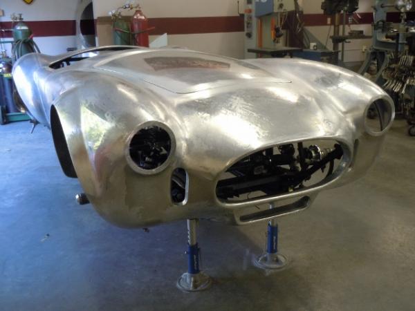

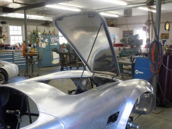

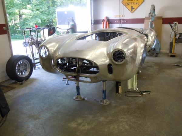

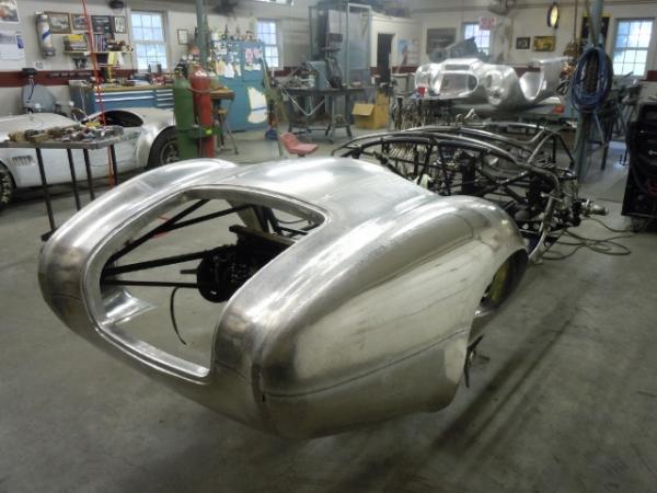

Since the last posting the doors have been gapped and final fitted, wire installed in the front wheel arches. All metal finishing completed forward of the rear wheel wells. Hood is gapped and fitted. The only work remaining is to skin the deck lid and fit, wire the rear wheel wells and metal finish weld seams. This shouldn't take much longer.

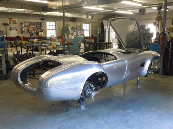

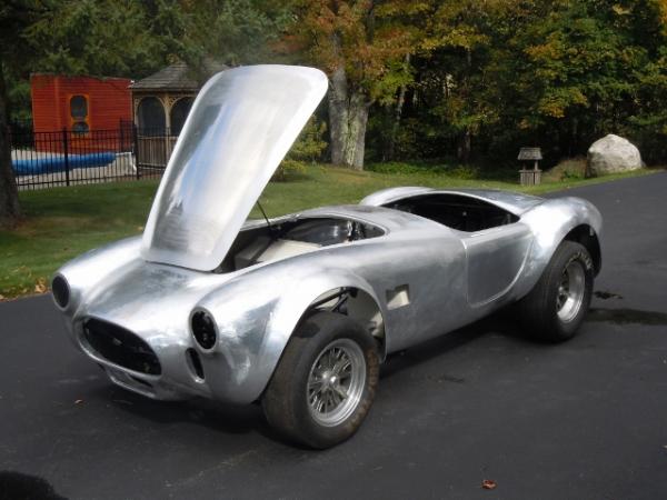

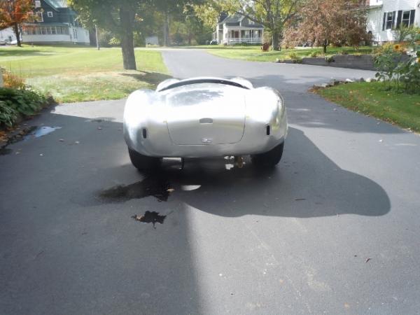

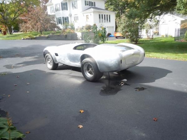

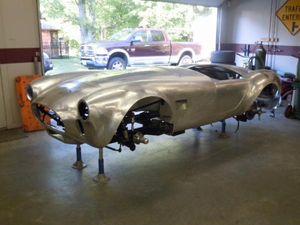

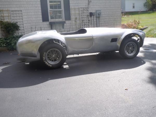

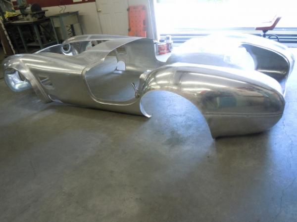

ThePanelbeater 10-07-2012 06:25 AM
About three weeks ago we completed the construction and mounting of the body. We've since started fabricating cockpit sheet metal and wheel well closeouts. In addition to this the customer has decided to not paint the car and go with a brushed finish which we are also doing.
