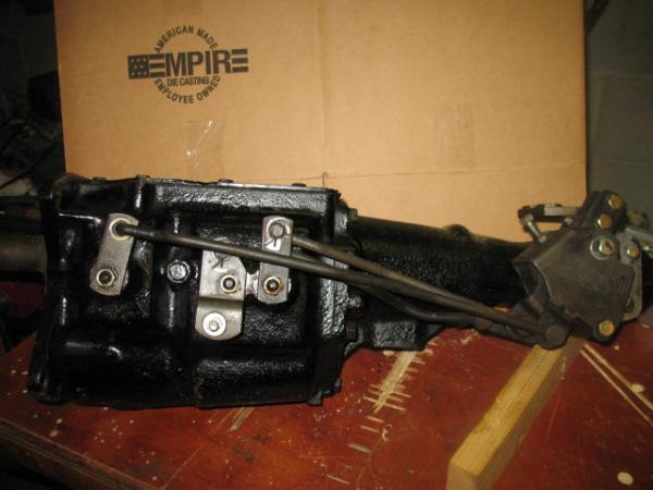

Does anyone have a good picture of their Toploader transmission with the Hurst Shifter and rods mounted? I bought my shifter used and since this is the first Toploader I've owned, the rods are a bit of a mystery. I think they are Hurst rods since it looks like they have Hurst bushings in them - but not sure.
I found the Hurst instructions on ERAs website which has an exploded view and I think I can figure it out from it. But a side view picture showing the up/down orientation of the levers and in/out orientation of the rod ends would be a help.

Tom Cimino 07-15-2012 01:04 PM
http://www.clubcobra.com/forums/pict...d=8223&thumb=1
http://www.clubcobra.com/forums/pict...d=8224&thumb=1
Here's two. Toploader with Hurst Competition Plus.

Thanks. All transmission shift levers are up above the shafts. I wasn't sure about that.
