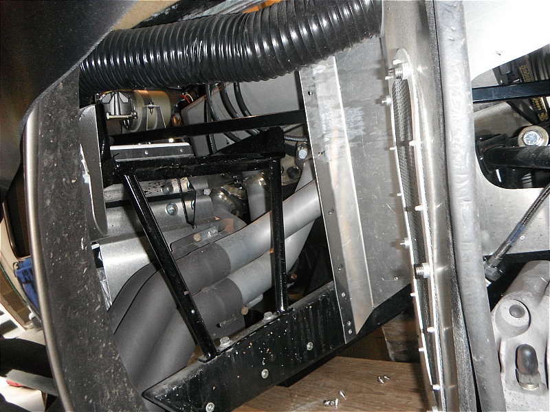

Hey Don and Patrick,
Both of you mentioned heat shields. I got the wheel well vents but missed the heat shields. I just found them in the manual but the drawings don't really show much and I can't picture what they look like installed. I haven't installed an engine yet, so I assume the heat shields would be pretty easy to add? I can contact ERA, but thought I'd ask you guys since you both have them.
Regards,
Kevin
patrickt 02-13-2013 04:14 PM
Think of the shields as "upside down L-figures." They're made of aluminum, are custom fit, and each side is different. You can see the shot of my passenger side, through the wheel opening, with the wheel well vent and battery removed. The other pic is of the driver side, with the wheel well vent still there -- so look through the mesh and you can see the heat shield over the pipes. Installation is a pretty easy, straight-forward job... meaning it will take most of the weekend.:LOL:
http://www.clubcobra.com/photopost/d...travent001.jpg
http://www.clubcobra.com/photopost/d...travent002.jpg
kevins2 02-13-2013 05:02 PM
Thanks Patrick, I'll call ERA and order a set. Interesting that the manual states the passenger side shield is only used when the battery is moved to the rear. Apparently, that only applies to newer cars or you found a way around that. I have the trunk-mounted battery so not an issue. By the way, you seem to have photos of every square inch of your car from multiple angles...
