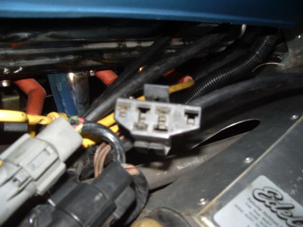

Dwight 02-26-2013 07:01 PM
If it's a Ford EFI '83 -94 EEC-IV computer it will have a number on it, A9L, A9P. If you have one of those then you will need a custom chip to make all the new parts work correctly.
Is you computer located on the passenger side footbox? Most 5.0 EFI Mustangs had their computer in that location.
I would think any shop that worked on the 89-93 5.0 Mustangs could installed the parts and get the motor to run as it should.

chomama1 03-01-2013 04:34 PM
[img][/img]
This is somewhat blurry photo of the computer connector in my Cobra. At least that is what the mechanic told me. It doesn't look like the standard "D" connector that most Fords have.
