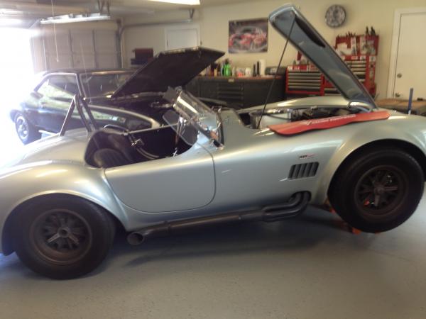

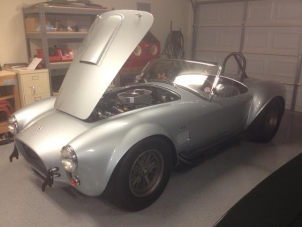

You can refinish them to look very original and with the weathered patina. My car get more compliments on the wheels than anything else. We color matched a 45 yr old Halibrand center then added black and graphite to the mix and sprayed the wheels on a home made wheel polishing machine using a detail gun and lots of reducer. Kept spraying until the final look was correct. As I drive the car, (4000 miles of hard driving in the last year), I don't clean the wheels. The accumulated brake dust from the CR Girlings and road grime makes them look even better. I only wipe down the original spinners after I reinstall the wheels-typically they are smeared with Never Seize after I get them hammered on.
It is doable.
GRUFF
http://www.clubcobra.com/photopost/d...s/IMG_5084.jpg
GRUF78 04-10-2013 10:04 AM
Another couple of pics with more miles on them.
http://www.clubcobra.com/forums/pict...d=9889&thumb=1 http://www.clubcobra.com/forums/pict...d=9890&thumb=1 http://www.clubcobra.com/forums/pict...d=7758&thumb=1

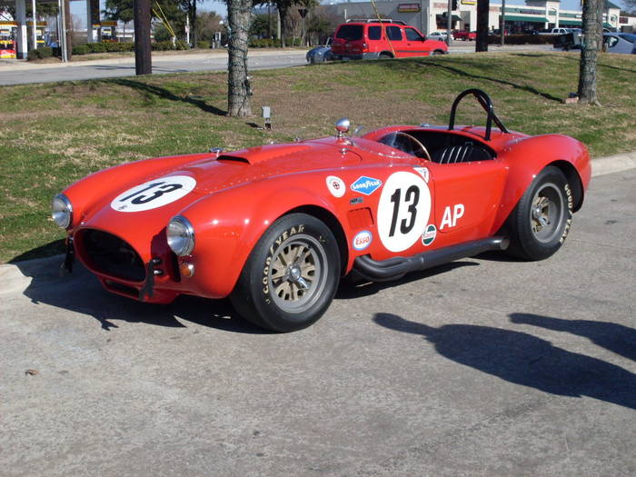

I was talking to Nick Action the other day and he did a set of new wheels that look pretty original also. He also told me someone mentioned to him they used citrus juice and aluminum polish on a bare wheel and it turned them in to 40 year old looking wheels. I was talking to a guy last weekend in San Marco Texas Cobra Club meet with an ERA FIA and he just some gray and black primer and made his FIA wheels pretty old looking also. Guess you need to experiment like John did....
Here is CSX 3020 that is in Dallas......
http://www.clubcobra.com/photopost/d...l_Comp_Car.JPG
