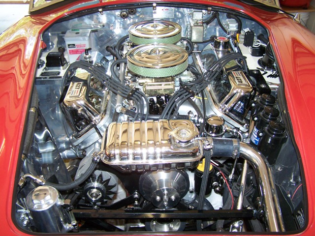

blykins 08-28-2013 03:00 AM
Edited........

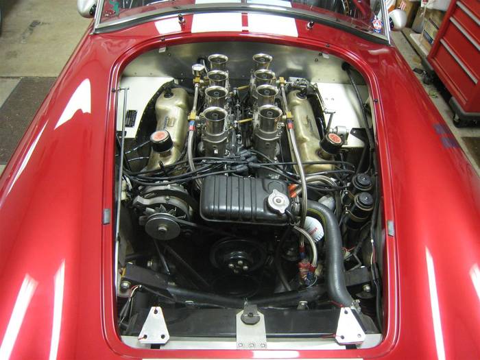

cobrajeff 08-28-2013 06:29 AM
Cleveland engines
The BOSS 351 engine from the 1971 BOSS that my Dad bought new looked perfectly at home in the engine bay of my '72 Pantera:
http://www.clubcobra.com/photopost/d...ium/eng_21.jpg http://www.clubcobra.com/photopost/data/3202/M_20.jpg
I had that engine in three different cars ('71 BOSS 351 Mustang, '68 Shelby GT500 convertible, and '72 Pantera) and put over 100,000 miles on it before I decided it was time to refresh it.
Now it looks perfectly at home in my ERA FIA:
http://www.clubcobra.com/photopost/d.../IMG_5599m.jpg http://www.clubcobra.com/photopost/d.../IMG_00831.JPG
In the seventies when the 351C, M, and W were new, most all of the performance parts were made for the Cleveland design. These days most of the performance parts available for Ford 351s are for the Windsor design. Guess I'm still :old school" - love my Charlie engine.
Jeff
diverrick 08-28-2013 09:15 PM
Jeff
How the heck do you get to the plugs??? Looks like zero room in the rear.
