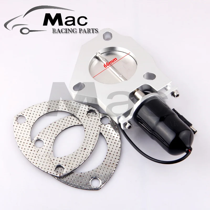

Depends on what you have. If you have a J-pipe - then is is not that complicated. You just shorten your J-pipe and put two of these, left and right with a T and a open down pipe in.
https://ae01.alicdn.com/kf/HTB1m_HmL...-b-valve-b.jpg
If you have four in four, you have to do surgery on your exhaust. The biggest problem is the ground clearance. Even with the steepest angle you losing 3 inches....
