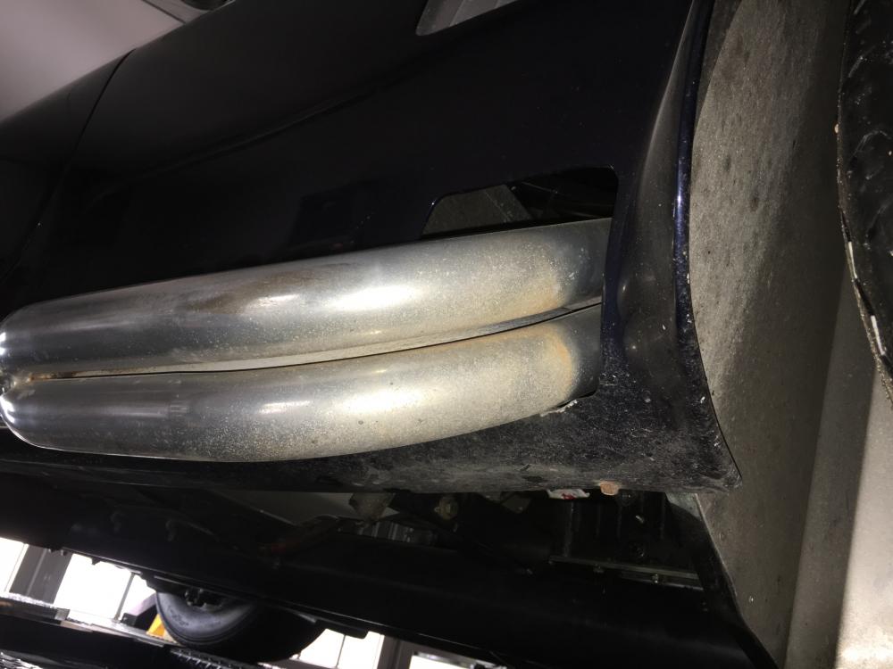

One of my side pipes is not properly centered in the cutout. It used to rub a bit on start-up, but has gotten worse and needs to be corrected.%/
What's the easiest way to correct this? Decrease the bend in the collectors? What's the easiest way to measure how much?
http://www.clubcobra.com/forums/pict...ictureid=16699
http://www.clubcobra.com/forums/pict...ictureid=16700
Snake2998 06-15-2017 08:23 AM
I think your choices are:
1/ Cut the hole slightly bigger.
2/ heat the side pipes and bend them slightly.
3/ Space the engine mounts.
4/ Shorten the header pipes slightly where the side pipes fit.
Which one you choose depends on you exact situation.

dcdoug 06-15-2017 09:00 AM
There has never been a lot of clearance on that side (passenger), but there was always a gap. The other side is fine, so raising the engine would solve a problem and create another. The motor is coming out (see my thread on the metal I found in the oil pan) so I can inspect the mounts and possibly replace them with urethane mounts. I have OE style rubber mounts now.
My guess is that bending the pipes will work best, but will be more finicky to get right as I'll have to have someone bend them. Any suggestion as to the best way to measure the amount of bend I need so I can get a shop to bend it right the first time?
Mark IV 06-15-2017 09:54 AM
You need to shim the mount on the low side, leave the other side alone (although it will change slightly with the other side shimmed) and do use a good urethane mount. The urethane will allow less "rocking" and reduce the engine movement.
Bending the inputs to the side pipe will be difficult as they are welded to the collector and are a "unit". It would be easier to bend the header pipes "up" a like amount and allow that to reposition the side pipe in the opening.

dcdoug 06-15-2017 10:35 AM
Thanks for the suggestion. I'll look at the size of shim required to sufficiently move the pipe before I pull the engine. Any recommendations on urethane motor mounts? I found these on Summit: https://www.summitracing.com/parts/t...view/make/ford

dcdoug 07-08-2019 08:11 AM
I had original rubber motor mounts and one of them was starting to collapse. I replaced both with solid motor mounts from cobrakiwi (very high quality pieces). My passenger side motor mount was previously shimmed about 1/8" and it made sense to leave it that way. After putting the headers and side pipes back on, but before tightening them up, I loosened up the motor mounts and used a transmission jack and 2x4 to tweak how the motor sat on the chassis to center the pipes in the cut out. It's perfect now.
I haven't repaired the fiberglass at the bottom of the cutout. It's not very noticeable. I'll probably do it someday.
