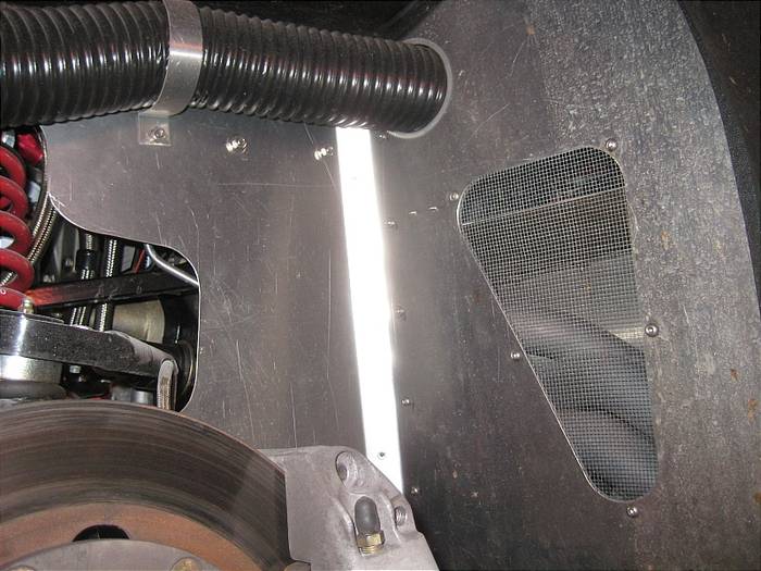

HTM101 12-31-2018 07:25 AM
Originally Posted by Blas (Post 1455908)
Could you please send a pointer directly to these wheel well vent photos? I would like to see some variations of what has been done already if anyone has them installed.
Winter project.... thanks
Blas
Blas,
Here are several shots of the wheel well mods I made.
http://www.clubcobra.com/forums/pict...ictureid=18025
http://www.clubcobra.com/forums/pict...ictureid=18027
http://www.clubcobra.com/forums/pict...ictureid=18026
Blas 01-03-2019 07:15 AM
Thanks to all.... looks like a good winter project. Does it add additional dust etc to the engine compartment in anyone’s opinion? I find the #7 up on jack stands photo but see no wheel well vents in that photo just the side vent. The link posted take me to some weird advertisement site.

HTM101 01-03-2019 01:57 PM
Blas
Possibly a tad bit more dust, as I opened a large area. I anticipated more dust and debris than actually occurs.
The modification has been a positive gain in heat management during slow speed driving.

Blas 01-03-2019 07:08 PM
66AC - it was the screen vent on the rear sections of the wheel well I was referring to in my post. But thank you for your time and effort.
HTM101 - very nicely done screen and surround. You should sell those things I will have difficulty in matching the same quality in what I fabricate...well done!
Blas
