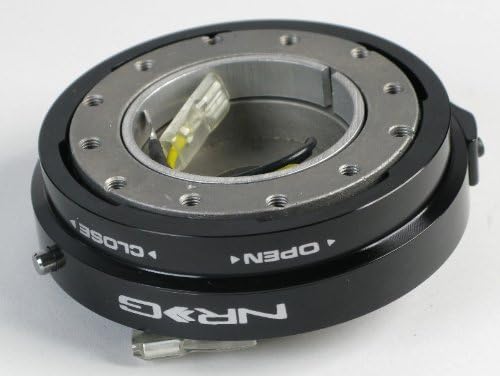

The QR adapter I found most attractive was the low profile NRG SRK-400BK unit because of its low height (24mm) and its tight (locked up) condition when the wheel and column are coupled up. The actual unit is available in black, silver and a bunch of other colors. Once installed the black and silver color options nicely hide the presence of the QR system, making it look like either a part of the steering column or the steering wheel. It is easily missed / invisible unless you deliberately look for it.
This is what the actual QR coupler looks like with both pieces, assembled. This is the steering wheel side. It is drilled for both a 70mm and a 75mm steering wheel attachment bolt circle.
https://images-na.ssl-images-amazon....DviwL._AC_.jpg

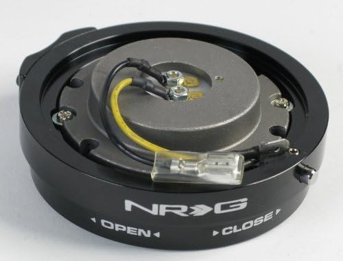

And this is the steering column side;
https://images-na.ssl-images-amazon....vL9nL._AC_.jpg
The unit supports a center horn button and while I suspect you could wire it up with sufficient motivation it might be easier if you don't — as you'll see later.

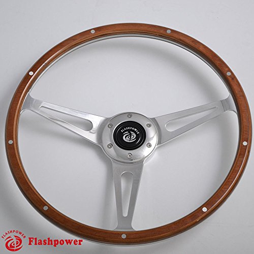

https://images-na.ssl-images-amazon....15TUNYdBFL.jpg
It is not exact, but it is close ~ $150.
If you have big hands, prefer a thicker wheel rim to hold on to and want a wood appearance this wheel is a ~$63 item that will nicely fit the bill. It is also the wheel I chose;
https://i.ebayimg.com/images/g/j2YAA...R3/s-l1600.jpg
I prefer a cushioned leather wrap as opposed to the, harder to the touch, wood finish and I prefer the larger diameter rim grip on this wheel compared to the more original looking alternatives above. For about $10 more you can buy a genuine leather cushioned wrap, which you will get to personally stitch up (stitching holes are already punched out).

If you ignore the drifting wheel offsets which are over 3" (and small diameter) you will come down to a choice between two offsets neither of which is zero. Most manufacturers offer a 2.5"/ 2.75" offset which is their deep offering. The second offset is a 1.5" / 1.75" (or so, they seem to move around a bit) which approximates our original steering wheels. I have yet to find a zero offset wheel with the Moto Lita look our cars came with
The two Cobra look similar wheels In my post #27 above are likely the closest you are going to get to your desired wheel geometry. That said, other than the time consumed, there is always the chance additional searching could turn up something for you.
