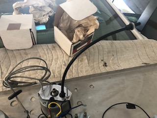

mvanhorn8893 12-15-2021 07:37 AM
I have the CW Smiths Speedo but I had to make a retaining bracket to be able to install/remove the Odometer cable.
