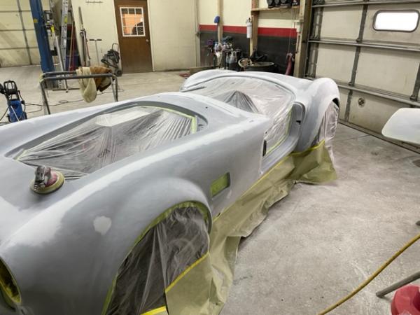

Chicagowil 03-25-2023 07:49 AM
The body shop applied the 1st coat of urethane primer for fiberglass, sanded and preped for 2nd primer coat.http://www.clubcobra.com/forums/pict...=20778&thumb=1
We reworked the original hood scoop buy removing the 8" of added width (modified for previous supercharger now removed) and reinstalled with a 3 " added strip in the middle to clear the EFI system.
http://www.clubcobra.com/forums/pict...=20392&thumb=1
http://www.clubcobra.com/forums/pict...=20777&thumb=1
James block sanded the entire car, carefully looking for imperfections and pin holes.
He then did another coat of the primer.
http://www.clubcobra.com/forums/pict...=20776&thumb=1
http://www.clubcobra.com/forums/pict...=20779&thumb=1
I decided on Viking Blue 2 stage paint with no stripes.
http://www.clubcobra.com/forums/pict...=20780&thumb=1
The car should see color this coming week!

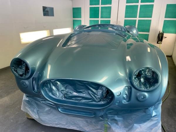

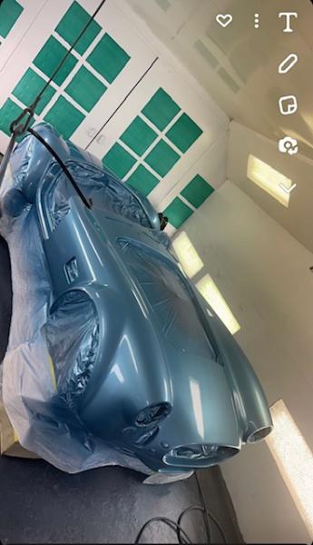

Chicagowil 03-28-2023 06:29 AM
Color on the car!
Did not get to see the car yet. James sent me this photo last night just to tease me.
Hope to get there this afternoon.
http://www.clubcobra.com/forums/pict...=20781&thumb=1
I am happy with my choice of color.

He knocked it out of the park! I got to see it today- still in the booth. The color looks even better in person. He has to color sand it & buff it yet. I am very pleased with the paint and really like the scoop.
The scoop is not like an original 427, but the whole car is more of a "tribute", and I always accepted that.
I have always enjoyed the story as to how the riveted scoop came to be. They had tried a new config for the motor intake and the hood would not clear. So, someone went down to the closes speed shop and grabbed a fiberglass scoop, cut a hole and riveted it in place.
Then, it somehow becomes an "engineered add".
http://www.clubcobra.com/forums/pict...=20784&thumb=1
The color seems to really enhance the curves, IMHO.
http://www.clubcobra.com/forums/pict...=20783&thumb=1
