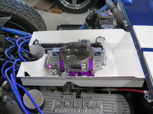

SOME PICTURES WOULD BE NICE TO SEE WHAT YOU ARE WORKING WITH. If you haven't gone to an air box you should consider it as it will drop your carb temp that it maybe enough to solve your problem. Look at the air box in my album.http://www.clubcobra.com/forums/pict...=21292&thumb=1
BillK
If it were easier to upload photos you might have them. I’ve got an oval Cobra air filter on top of an Edelbrock carb.
