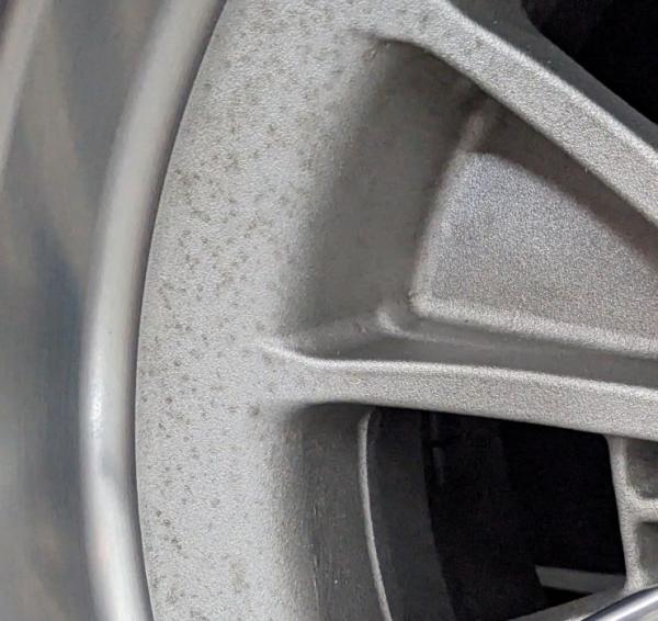

Hello guys,
lets give you a short update to that what I did, because meanwhile I cleaned my rims as mentioned.
But to remember to the reason of this thread, first a screenshot to the situation how it was at the beginning of the cleaning procedure:
http://www.clubcobra.com/forums/pict...=21403&thumb=1

And this is the result:
http://www.clubcobra.com/forums/pict...=21402&thumb=1
... almost as new - I am happy!
