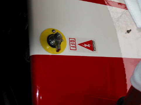

When Dennis Olthoff put the full width rollbar on my SPF, it left a hole on the rear deck, just behind the cockpit. So for some months i have had a big amp Moroso battery cut-off switch stuck there, but not wired in. Looked nice, but i don't like non-functional sorts of car things, and at several track and top speed events, the tech inspector would say "good, an external switch", but of course, all he had to do was to peek under the rear of the cockpit, and see that it wasn't hooked up to anything.
So this past weekend, put two grommets in the rear bulkhead, and ran some big gage wire and did it right, with proper metal insulated supports were appropriate, to avoid any chafing and resultant sparks.
Since i always disconnect power before doing any work on my car, it is nice to be able to do it so easily, although i still have the trunk mounted cut-off switch in the circuit.
here is what it looks like.

Hal Copple 01-21-2004 07:24 PM
ok, let me try to make it larger. I don't quite have the hang of this picture stuff yet.
http://www.clubcobra.com/photopost/d...off_switch.jpg

Hal Copple 01-22-2004 06:21 PM
thought i would answer a few of the above considerations.
First, i need to get another sticker, because i put the big Off sticker on the car when it was a dummy switch, and i rotated it 90 degrees when i installed it, for better cable routing, so now the big Off actually points to the on position.
Next, on SPF's the rear bulkhead is inset a few inches under the rear of the body, so the switch is actually totally in the cockpit and not in the trunk. No real risk of gas fume ignition.
As to turning it off, and having the engine run, to some extent this is true. Bob Olthoff told me that once the engine is running you can take the battery out of the circuit and the motor will run due to "self excitment" of the alternator. But he assured me that this is much higher than my idle, and that my motor would die. But this is not a consideration for me, as the Moroso switch i bought has a spare lug on it, that will ground the coil wire too at the off position, if i run a coil wire to it.
I wanted a switch that would carry a big amp load, and not have a removable handle, so it wouldn't disappear on me.
