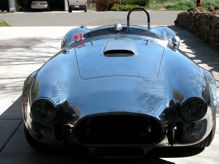

Bluedog 04-25-2004 11:54 PM
Re:
Check out Stroker's and Pat Buckleys wind screens in the gallery...amazing workmanship!
Bluedog

Aussie Mike 04-26-2004 02:46 AM
After browsing through the galleries I've come to the conclusion that Pat has built the nicest looking Aero screen in my opinion.
I think I'll have a go at building something like it.
The more I look at Pat's cool looking screen the more I think the car might stay that way if I build one.

PatBuckley 04-26-2004 10:41 PM
Hi Mike,
The screen is made from 3/16ths Lexan - get the hardened variety, 9" X 48". The attachment "bracket" is made from .040 aliminum that I stretched to shape following the "footprint" of the original windscreen so that if I go back to the big heavy glass screen the mounting holes will be hidden.
Pat
Aussie Mike 04-27-2004 12:09 AM
Thanks Pat,
That Cobra of yours is rolling Art.
For the bracket did you start out by folding a straight strip of aluminium at the right angle and then stretch the bottom edge using a lancaster or similar stretching tool? Lancaster I think a friend of mines Dad has bought the shrinker and stretcher so I might be able to borrow one. Or was it careful hammer and dolly work?

PatBuckley 04-27-2004 06:57 AM
Mike -
I used a metal stretcher - do NOT bend it at 90 degrees - I bent mine to about the angle I wanted - something a little flatter than stock.
You have to then use the stretcher on both planes about the same amount as the "curve" is vertical and horizontal.
Anneal first and get a few extra sheets cut and bent so you can practice first (if you are new to this).
Pat

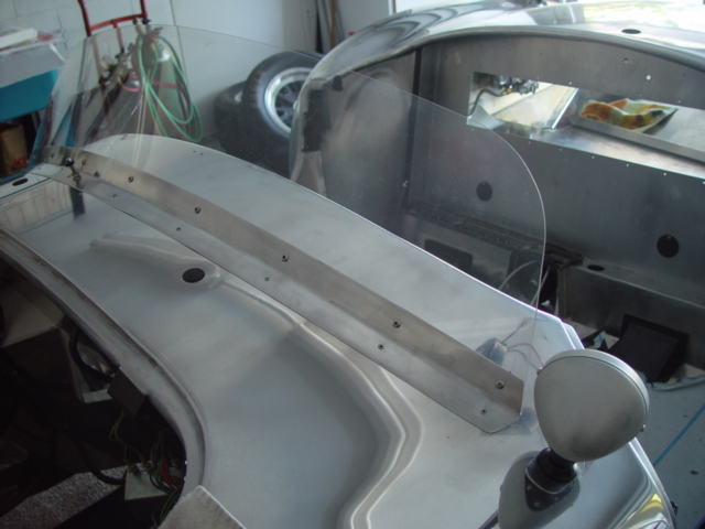

Ant 04-04-2009 11:20 PM
Aero Screen
Pat, Mike
My screen is about a 45 degree angle, I guess with the short 9" high screen it might be a mistake to do at 45, if thats what you mean!
I have available a shrinker and stretcher all on high stands so before they go back I will give it a go!
