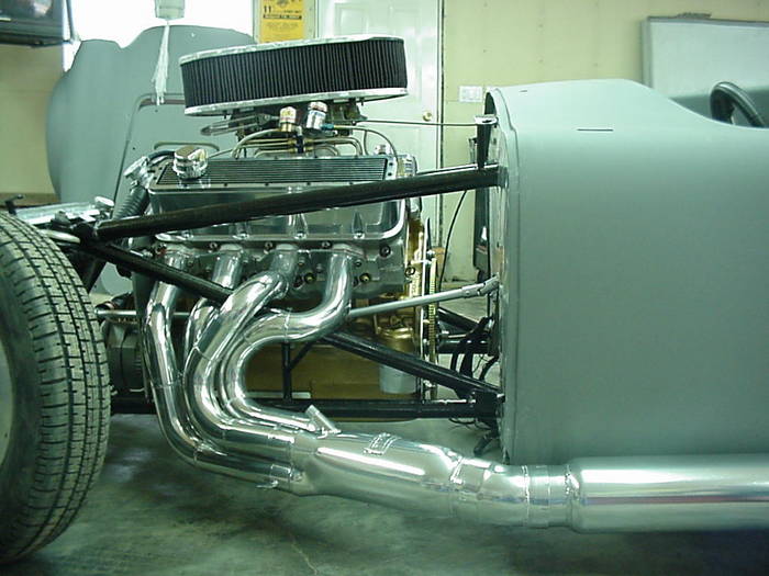

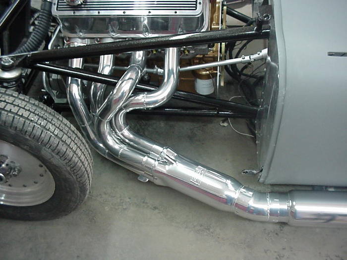

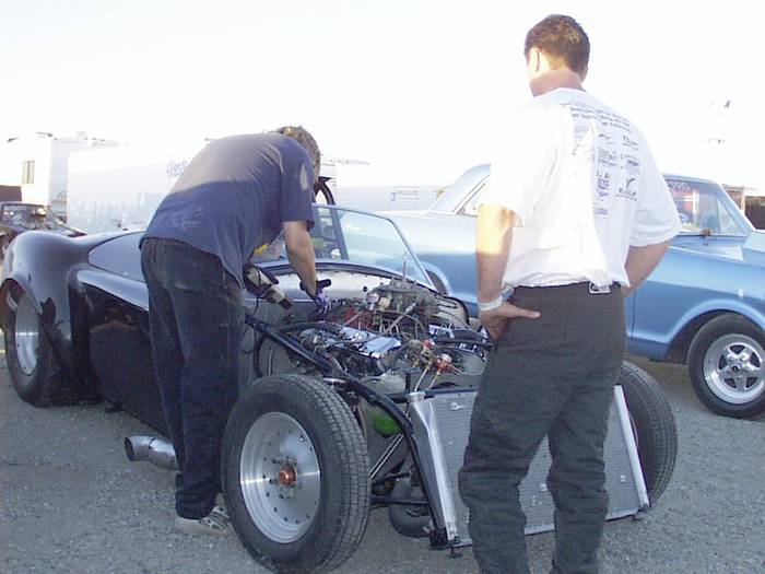

colin mullaney 05-17-2008 08:20 AM
Thanks Rick, I don't have many photos other than what's in my gallery. I'll try to post a few. The engine is a 600 cubic inch BBC with Bow tie block, Callies crank, Oliver rods, Diamond pistons, Brodix 2Xtra heads, 1340 cfm Dominator carb, and two stages of nitrous (one fogger, one plate). The transmission is a two speed powerglide with a GM 14 bolt rear end (10 1/2" ring gear). The engine has previously dynoed at 880hp and reached 1370 hp with both stages of nitrous. I hope to go faster this year as I have increased compression from 10.3 to 13:1, installed a larger roller cam, put 100 hp larger jets in each nitrous system, and changed from 3.73 to 4.10 rear gears. I would prefer it was Ford for purity sake but I don't care much, I just want to go fast in a beautiful car.

RICK LAKE 05-17-2008 05:07 PM
Thats brutal. Super Gasser didn't go that fast.
Colin Mullaney With the changes to the motor, I going with 7.30's at 188-190 mph if you can hook. You need some couch time.:rolleyes: Hope you have a Pro license. You could carry the front wheels through the 60ft beams. Only 600 cubie inches?:confused: You must be sand bagging.:rolleyes::LOL::LOL: Pat Musi is only 1/2 hour away, I might be able to borrow a 700"+ motor if you get serious about this.:rolleyes:;) Talk about fun and games, does anyone come out and play with you?:eek: Looking forward to seeing more pictures. Good luck with the assault on the sound barrier. 6.999 at 200.0 mph. :MECOOL: Rick L. Ps is a jet engine next??? Jay leno as one and way too much money and toys.:rolleyes::LOL::LOL::LOL:
colin mullaney 05-18-2008 08:02 AM
I do have IHRA and NHRA licenses but the car's barrier is 7.50 seconds. The chassis is mild steel and can't be certified for any faster. I'm not sure what I'll do once I reach 7.49. I'm actually reassembling the engine currently and hope to be on the dyno in a few weeks.
