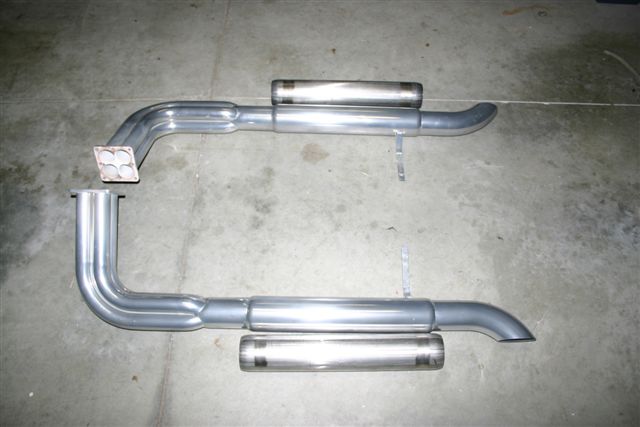

This update will cover the fabrication work on the pipes. Here is how everything looked after I pulled the stock (and ceramic coated) Superformance side pipes from #747:
http://www.clubcobra.com/photopost/d..._Stage_2-1.JPG
As you can see, the Stainless Specialties custom mufflers were built to exacting specifications, with exception to my requirement to add one (1) inch of length to the case. As was discussed prior in this thread, this was done so that the fabricator had enough material to work with to maintain the exact length of the entire assembly from the collector to the tip of the tail pipe.

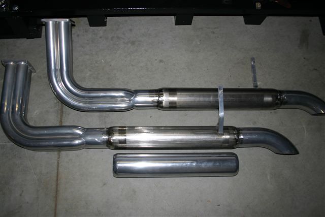

Here is an "after" shot of the side pipes once Alex Mikkelson of American Roadster (Placentia, CA) did his magic. I laid a factory muffler beside them for reference:
http://www.clubcobra.com/photopost/d..._Stage_2-2.JPG
Alex is a pro, having done all the chassis work on the recently restored BankAmericar front-engine top fuel dragster. He also did all the chassis work on the Hot Rod eBay rail dragster (both cars were heavily featured in the magazine). Alex's attention to detail was incredible, as he built a temporary jig out of scrap tubing and spot welded it right to his work bench! This allowed him to match all of the correct angles, lengths and attachment points (especially for the side bracket, which had to be dead spot on). Alex got $250 for his efforts and I was more than pleased with the work. Word to the wise: Muffler shops can't handle this type of work. If you are not an advanced welder, then farm out the work to someone that knows what they are doing.
I did a quick reassemble to ensure everything was true and both sides bolted up with hardly much effort (driver side was too easy and the passenger side was maybe 1/16" off...a little coaxing got the side bracket to match up). Unfortunately, I did all this in the wee hours of the morning and couldn't fire it up.. So I tore it back down and that same day sent the pipes out to Embee Coatings in Santa Ana for a fresh ceramic coating (just as before). Embee gets $300 plus tax for their efforts.
I will get the pipes back in roughly two weeks time, in which I will then report on the sound and performance. "Eric" has another thread going on right now in which he has performed a near-identical modification to a similarly configured (stroked Windsor) Superformance. He's reporting over 20HP and 18FtLbs improvement with just minor jet tweaking (to compensate for the lean condition that the better breathing will cause). "Karl" is another CC member that did this exact same mod on a 514CI Superformance. He says they sound "crisp", certainly louder than stock, and the seat-of-the-pants performance increase is a seat wetter! Woohoo!
Stay tuned for the final chapter on this whole odyssey, which has cost me about $950 once you add in some new gaskets and all new grade 8 fasteners for the flanges. Some may say that this is a lot to spend for arguably a 20HP increase. Consider two factors. (1) The factory headers are not Hooker Super Comp quality, so those will eventually go next, and (2) I was after a much more aggressive sound versus achieving the power increase (which was obviously going to occur).

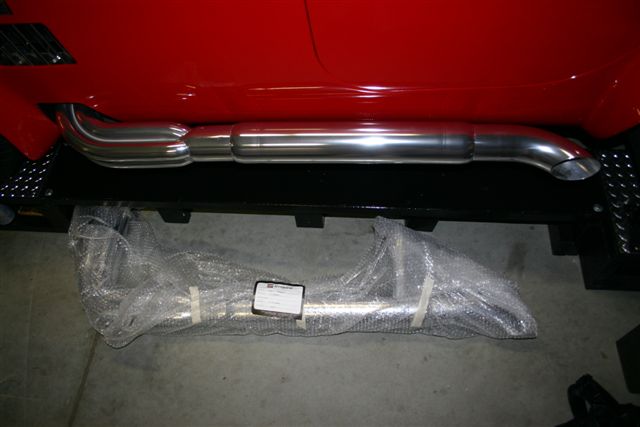

Well, for the faithful that have been following this thread for the past few months, I now have the final results in (well, sort of!). Here's a quick pic of the driver's side installed, with the passenger side still in the wraps from the ceramic coater:
http://www.clubcobra.com/photopost/d...32IMG_3147.JPG
First of all, these pipes came off a whole lot easier than they went on! Of course, doing this as a one man job required some dexterity and ingenuity (blocks of wood to prop up the other end), but it all went together as nuts and bolts should. You will also notice that the new stainless mufflers have two ridges going around the pipe (each about three inches from the ends). These are where the inner core is welded to the outer shell. It's part of the design that went into these things, creating a chamber fore and aft to prevent too much expansion and splitting. It's not as "clean" as the factory SPF pipe that had no ridges from end to end, but keep reading and you'll then know why it's not a big deal to me.
OH MY GOSH!!!! THE SOUND!!!!! I think the best way to describe it is "all business." Night and day versus the factory SPF mufflers. If you are running a small block like me, you want this set-up. It will make your car sound considerably closer to a BB. Much more crisp sounding at idle and a great gurgle off idle. Get past 2,500 rpm and they really start to sing! If you want quiet, this is not the route for you. But let me tell you, they are not excessively loud. Louder than stock SPF 2" cores? Definitely yes. As loud as straight pipes? Definitely not even close to straight pipes. Just a gutsy "I can hear you from two blocks away, race car-like roar." Like I said, they will know you are "all business" as you approach.
I put about 10 miles on them, then re-tightened all of the bolts. I will need to jet-up a few notches, as it's undoubtedly running a tad leaner now. I also plan to take the pipes (on the car) back to Alex Mikkelson at American Roadster and he's going to add some stainless steel gussets to the side brackets. I should have had him do this when he did the the fabricating, but I neglected to do it and I'm already experiencing a slight crack in the passenger side (it happened during the re-install, not after I fired it up). We are going to use 3/4" stainless steel strap and he's going to mount it in such a way that the only people to notice will be the ones with their noses to the ground. Oh yes, he can definitely do this with the pipes on the car, so I don't have to yank everything apart.
Last comment. I don't want to lay blame on anyone else that has handled these things, but they did come back from the coaters with a couple tiny dents (smaller than a dime) on the passenger side pipe. They are noticable and I'll just have to live with them. I did not have the coater sign any kind of waiver prior to dropping them off, so I can't prove that their people put them there (although I'm 99% sure they did). When you consider the multiple steps they put piece of metal through just to ceramic coat them, it's no surprise when you see stuff like that.
In closing, this has been a very long project and has cost me close to $1,000 end to end. One with welding skills or access to friends that have the right equipment can cut into that cost significantly. For only having driven 10 miles, I'm a very happy camper with my re-born sidepipes. :)
