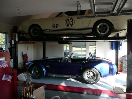

Just installed ours today after one week of garage modifications. I now have 14' clear to ceiling. Plenty of room to work underneath. Bought the hydraulic jack too.
Pro Park 7. 3.5 hours to install with friends helping.
