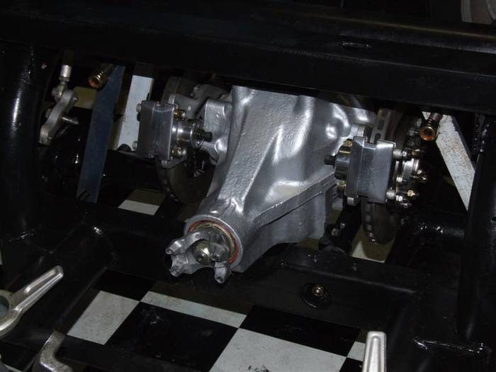

Much better ..heres the pics. It is a posi and I do believe a
Dana Locker JAGUAR rear end with an axle ratio of 3.54-1

I just wish I knew what I was looking for when it comes to brake parts and options for such ?
like what year this is etc?
767Jockey 02-27-2008 08:45 PM
Solid rotors, Girling calipers, looks just like my E type series II setup.
cobrajam 02-27-2008 09:28 PM
See how it how it has the 3 thinner ribs on the drivers side versus the one really thick one on mine. I think that is what he described as being the pre 68-69 E-type. Looks relatively clean and complete, even the rotors look to be close to the full thickness.
767Jockey 02-27-2008 09:32 PM
Early "E" types (Series I) had the Dunlop calipers with the bolt on aluminum pistons in cast iron frames. These are the one piece aluminum Girling calipers, they're Series II pieces.

An easy way is the front input flange on the Dana is the square one and the round flange is the Salisbury. Also the Dana Discs have to have two holes in them in order to facilitate removal.
John
Scufty 02-28-2008 10:08 AM
so mine is salisbury then
