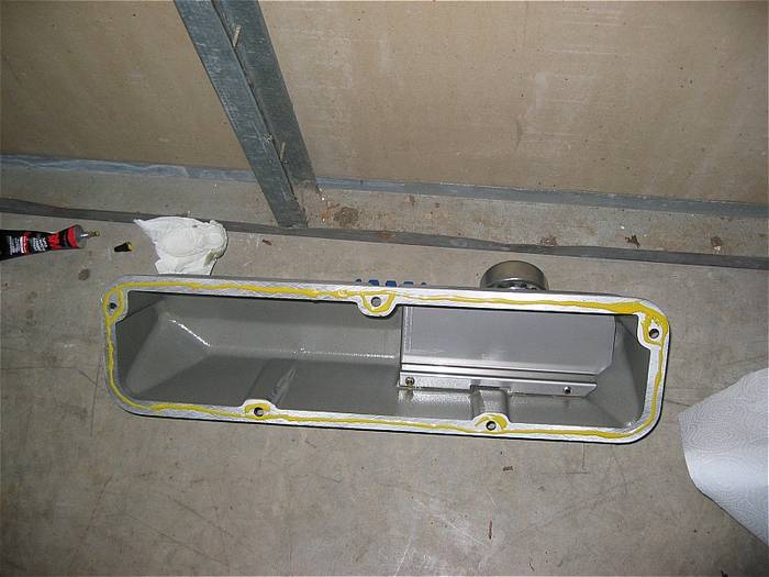

These are my Blue Thunder valve covers. The baffling fits over my Erson's with no problems.

sparks 05-04-2009 02:34 PM
I have the pent. valve covers. I think I mite try the rubber baffle that the breather slides into first. It will b close but for the cost I guess its worth a try. Patrick, I have no idea why all the valve covers arent equipted like yours ? Thanks

Patrick, I have no idea why all the valve covers arent equipted like yours?
Me neither; but I think you could probably weld a piece of sheet aluminum across the inside of your covers like that pretty easily.

Jamo 05-05-2009 10:32 AM
Most valve covers have bosses upon which to tack splash plates at the right depth...simply make sure they follow the same bend as the valve cover. They may not come installed since many folks use at least one for adding oil, and simply use a cap.
