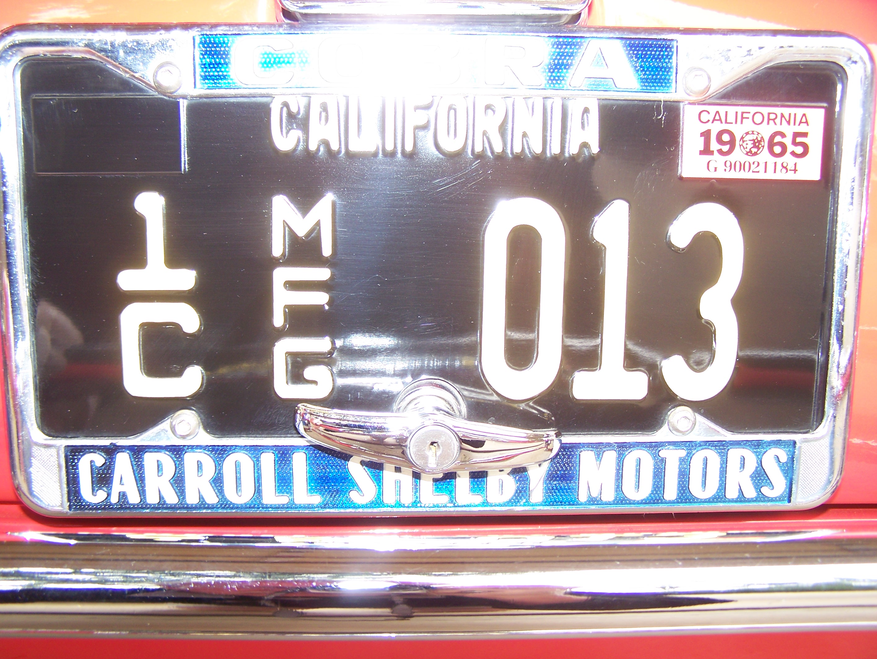

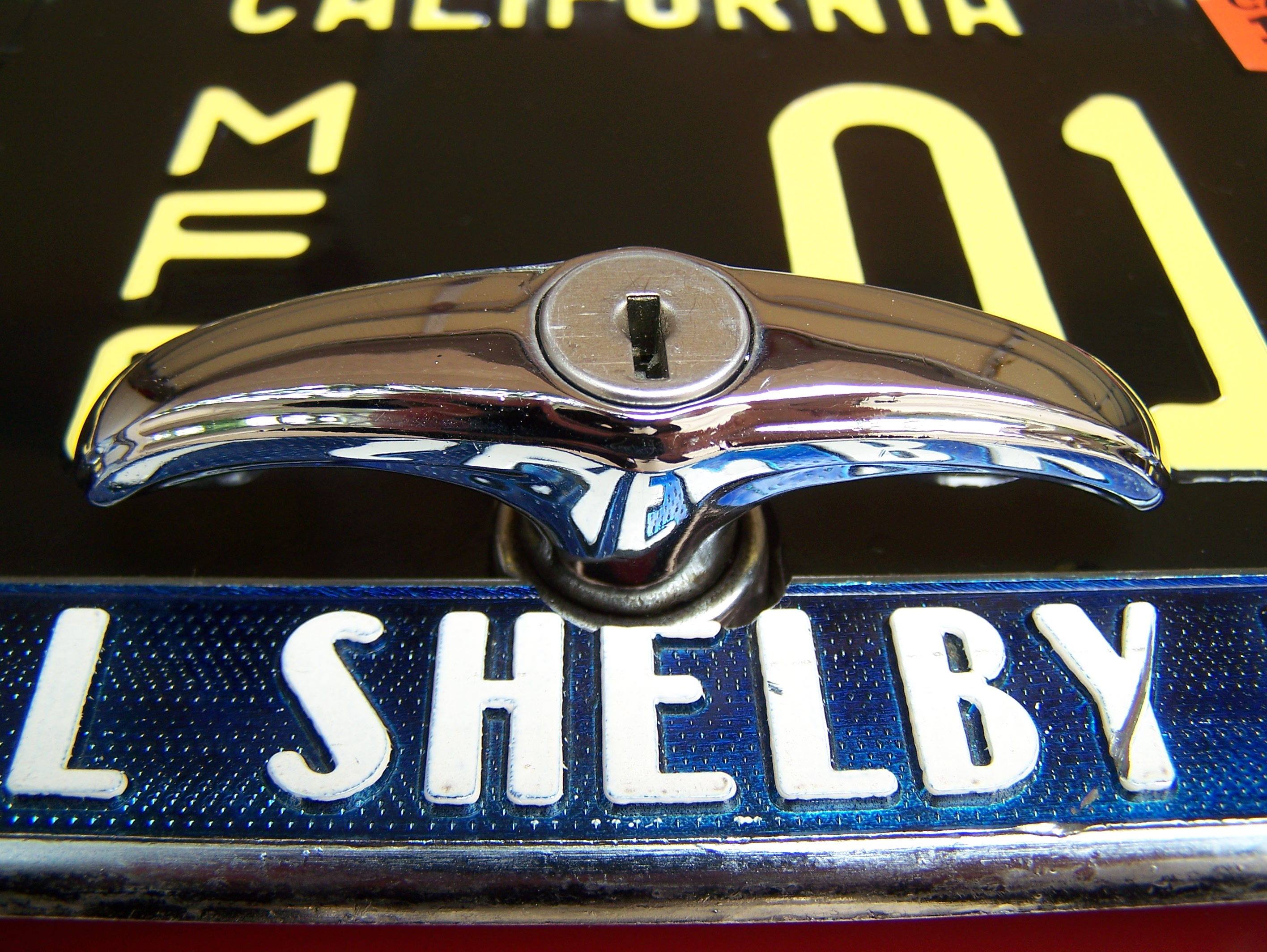

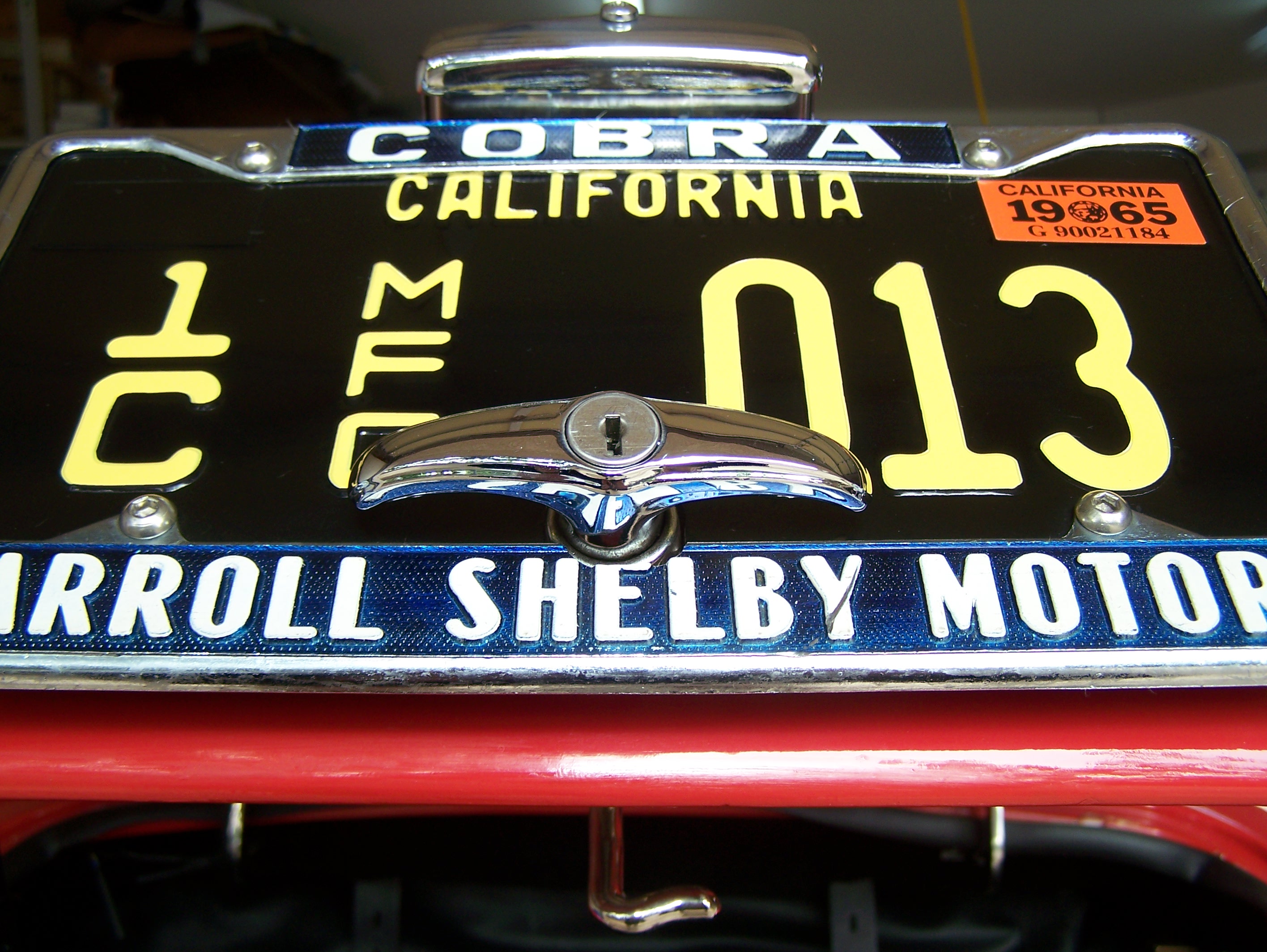

If the trunk handle is located in its original location, as Cobra bodies/chassis were made by AC in England, the distance between the bottom of the license plate light and the top of the handle assembly was sized for British license plates (wider than and not as high as US plates)
This causes a problem for mounting US plates. Your manufacturers solution was to relocate the latch.
I did this:
http://www.clubcobra.com/photopost/d...s/100_3255.JPG
http://www.clubcobra.com/photopost/d...s/100_3256.JPG
http://www.clubcobra.com/photopost/d...s/100_3257.JPG
