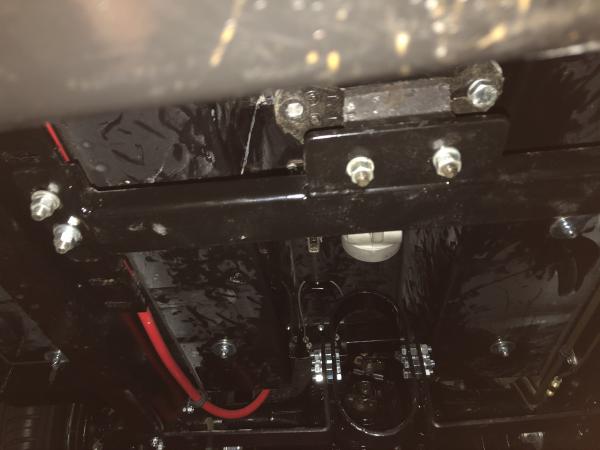

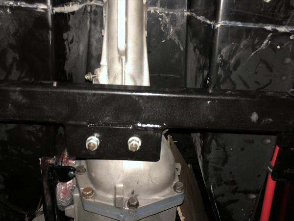

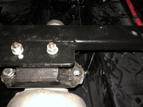

Here is my transmission cross member and how I'm going to use it with my T-5 trans.

I hope these help.
http://www.clubcobra.com/forums/pict...=18829&thumb=1 http://www.clubcobra.com/forums/pict...=18831&thumb=1 http://www.clubcobra.com/forums/pict...=18832&thumb=1
