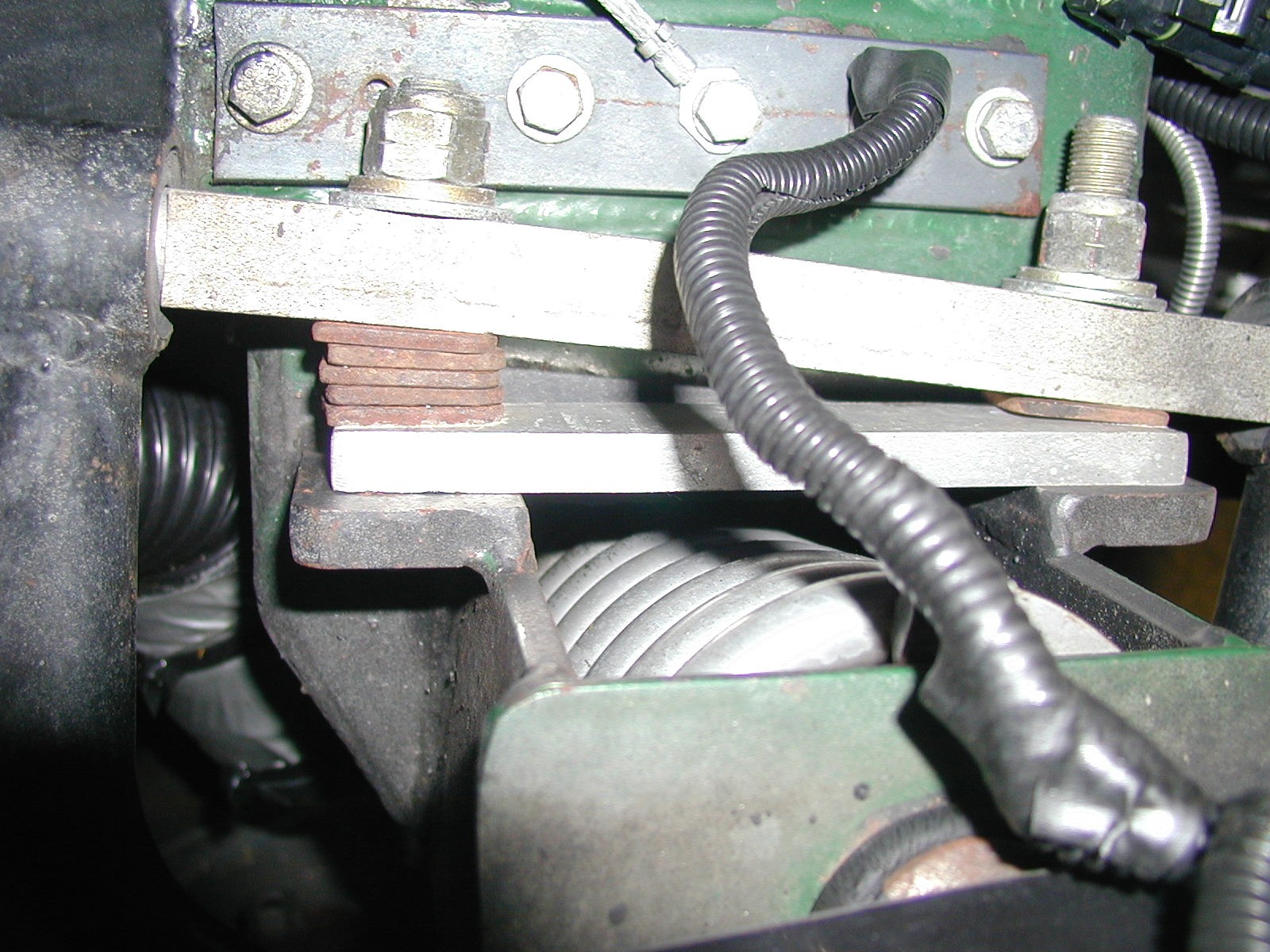

Roscoe 06-20-2005 10:12 AM
Jerry,
I just took some bar stock, 1/2" thick by about 1 1/2", cut it and notched out two "U's" so I could just drop it in.
Roscoe
Roscoe 06-20-2005 10:34 AM
Here is a large pic of the passenger side. You can see the spacer I made and the shims the alignment guy put in. This is setup with a 1.1 - 1.0 Camber, 2.2 - 2.1 Caster and a .10" toe.
http://www.priveye.com/dls/carm.jpg
Roscoe
