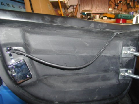

rdc767 09-08-2008 10:47 AM
Door latch driver side
The manual doesn't go to in depth with the door latching mounting. The passenger side just required the mounting of the striker side to be sanded flat. The driver side mounting of the latch needed a little shim or wedge.
After reading some threads here I was motivated to get the door to shut without opening the latch. :3DSMILE:
http://www.clubcobra.com/photopost/d.../door_shim.jpg
AMiller 09-11-2008 08:56 AM
I had to shim both sides. Didnt think they would latch without using the handle. Asked on the forum and found out I just needed to give a little more effort in the closing. Gave it a try and found both worked just fine.
Aaron
