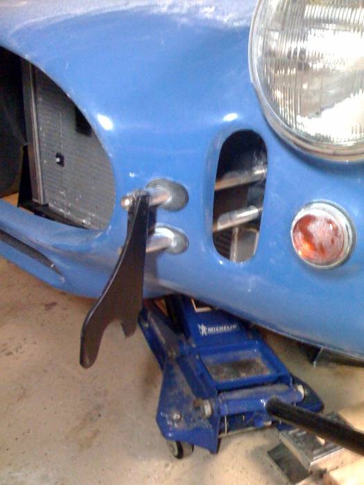

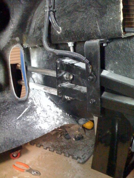

rdc767 03-06-2009 05:03 PM
Thanks guys I extended the threaded round untill it touched.
Just looking at that fiberglass dust makes me itch.
http://www.clubcobra.com/photopost/d...quickjack2.jpg
http://www.clubcobra.com/photopost/d...quickjack1.jpg
