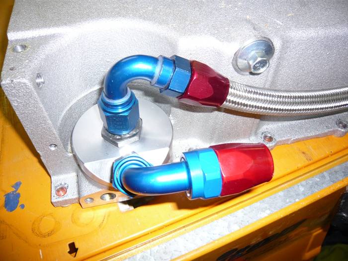

Aussie Mike 02-04-2010 01:28 AM
You can buy oil filter adaptors to suit the LS1. Unfortunately most seem to make it difficult to use AN swivel fittings with nice bends to reduce restriction. They end up hanging below the sump where they are easily snagged (not a good thing to have happen). It can also be difficult to get larger line sizes connected to them.
I came up with this setup shown on an LS2 Corvette sump which is significantly lower profile than the Commodore sump. These are AN #10 fittings.
http://www.clubcobra.com/photopost/d..._adaptor_2.jpg
http://www.clubcobra.com/photopost/d..._adaptor_1.jpg

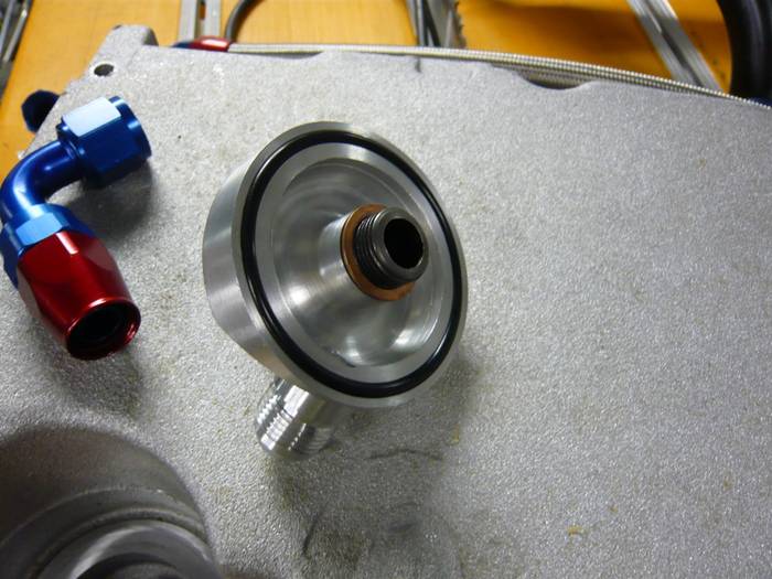

Here's the inside showing the O ring seal etc
http://www.clubcobra.com/photopost/d..._adaptor_7.jpg
I reckon you would be surprised at the oil temps in the Commodore towing the van. I don't think they are shown on any gauge nor are they monitored by the ECU. Also pulling it up a hill won't be done with your foot flat to the boards on and off for an hour as you would circulating a track.

Tight bends like those on the earls fittings are bad for flow and temperature control...they actually create or at least sustain heat. Not much can be done about this so the next best thing is Monitoring..Make sure your gauges read actual temps ..etc and not a general reading. Just my 02. cents worth....read "Engineer to win"
