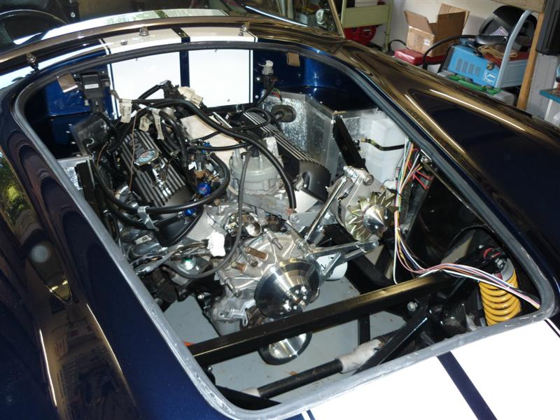

Wodnas 04-02-2010 10:21 PM
Geof,
These are brackets designed for mounting on RHS turned upside down. It fits OK but dont know that I'll leave it there as it looks a bit high.
http://www.clubcobra.com/photopost/d...81_Medium_.JPG
This is a March kit from Raceparts Yatala. Comes with all bolts, spacers, adjustment rod and rod ends. Only slight modification needed for spacer length and bracket to mount to head.
Bob
