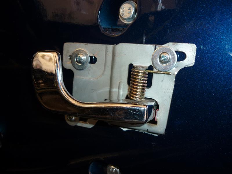

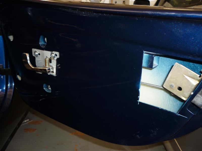

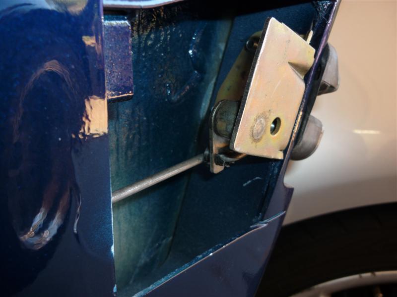

I,m pretty sure mine are Pajero. This is what I came up with. Not finished yet as I need to fit the covers inside.
http://www.clubcobra.com/photopost/d...es_Medium_.JPG http://www.clubcobra.com/photopost/d..._3_Medium_.JPG http://www.clubcobra.com/photopost/d..._2_Medium_.JPG http://www.clubcobra.com/photopost/d..._1_Medium_.JPG
Bob

Yours are the same as mine, i was thinking though that the mounting plate may need to be recessed into the fibreglass or the handle will stick out too far.
Won't the upholstered door card need to be quite thick to take up the gap behind the hanle and plastic trim part?
Wodnas 05-14-2010 06:03 PM
I measured the height of the door cards first and modified the mounting plate for the handles so that the plastic cover behind the handle would end up at the same height. I had to cut of some of the mounting plate and flatten other parts.
Bob

Bob's are the same as mine Gregg. They are Pajero, and rears if I am not mistaken. If you are fitting Warwick's 'custom' door mouldings you need to be careful to leave enough glass underneath on the flat 'glass panel to have the mouldings fit well at the rear where the locking component is installed.
byroncobra 05-15-2010 08:05 PM
Thanks Merv
I think the trimmer will make up the cards, i get what you're saying though. The cutout for the latch on my car is quite a bit smaller than on Bob's pic, so i guess that should be ok.
Did you modify and then fix the base plate to the glass as did Bob?
Merv and Sharon 05-16-2010 02:38 AM
No Gregg mine are different. Much smaller area of glass was removed and an 'edge' retained towards the outer part of the door, towards the latch. Like yours I suspect. I am away in Jakarta just now but will post some pics on Thursday, if you still are interested. We are all keen to see yours and Bob's cars!
