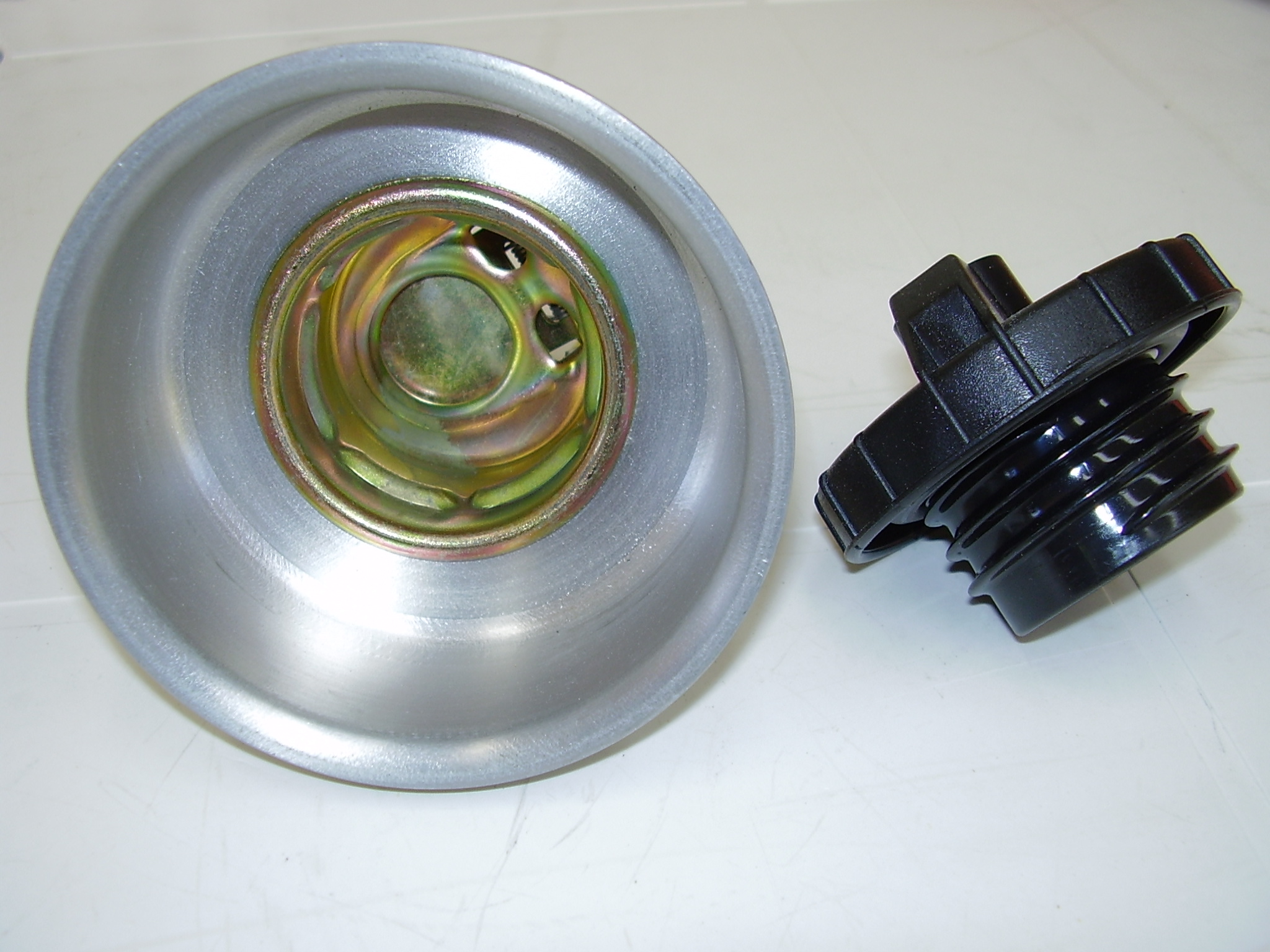

Rebel1 05-28-2010 04:17 AM
Yep Oz, same here. Here is a pic of the unleaded insert that's in that
filler.
http://www.clubcobra.com/forums/../p...bs/filler5.jpg

750hp 05-28-2010 09:38 AM
Originally Posted by Dumpling (Post 1054256)
if the sole reason behind this query is how to prevent an inferno....
The boot will always smell of gas, as will anything you carry in there.
Nah - I was just going for the tabloid journalism angle of overstating the most extreme outcome to get some attention.
If you look at the photo above, you'll see that carrying items in the boot is barely an option anyway. I have a couple of cars that I'd like to run fuel cells in, and figured it'd be nice if I can have a mod plate code that proves their legality for the street.
David - I agree 100% and I'm looking at options now. I can picture exactly what it looks like, and I'm a bit worried it might remind me of a dog that's just had an operation...!
