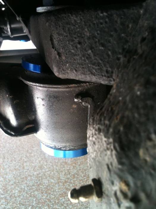

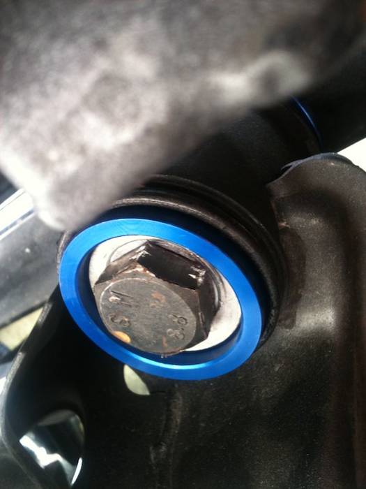

Merv and Sharon 07-01-2011 12:53 AM
Ally sub-frame collars fitted. Easy job and seems to compress the bushes well.
http://www.clubcobra.com/photopost/d...ium/Bush_2.jpg
http://www.clubcobra.com/photopost/d...ium/Bush_1.jpg

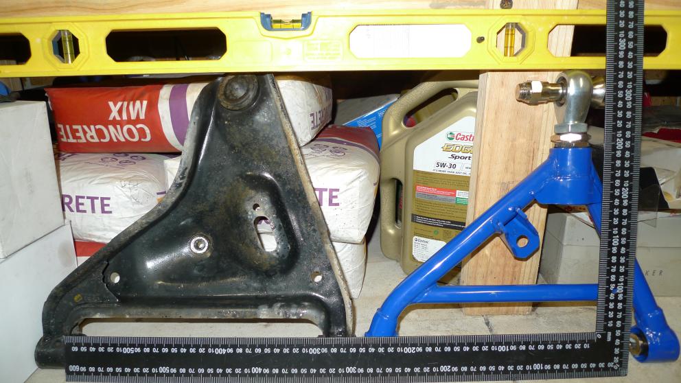

sambo 07-18-2011 04:53 AM
Leroy PM'd me for a comparison between the factory R33 lower camber arms and the aftermarket items. Like Leigh I'm interested to see whether this will allow us to bring the rear track inboard a fraction, in conjunction with the adjustable upper arms.
I'm still a while off refurbishing my new k-frame and fitting the arms but I've done my best to show the difference using a spirit level and builder's square. With the adjustable arm wound almost all the way in I reckon it might be as much as 10mm shorter/narrower.
http://www.clubcobra.com/photopost/d...0/P1020046.jpg
Sorry about the lens distortion, everything was setup nice and square I promise. :D
