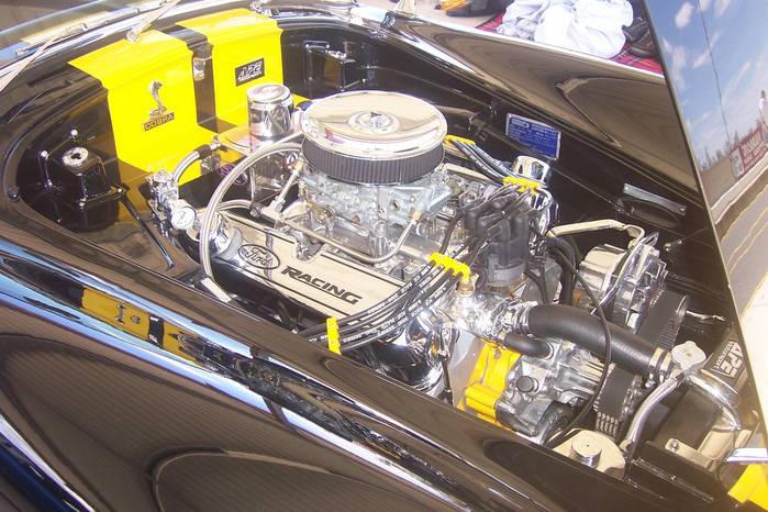

new 347 for my old drb
http://www.clubcobra.com/photopost/d...umbs/00112.jpg
Merv and Sharon 12-02-2011 03:38 AM
Very compact. Fine looking motor.

That's a pretty cool looking engine......Nice Sump !!
I'm gonna get one of those for the Race Cobra...They look the gear don't they ?

Now that's a motor. We ran edelbrock ribbed valve covers and their matching small round air cleaner in our old DRB.
Have you checked your underhood clearance? Looks like it will be tight.
Also we had to run a short oil filter.
1992 is an old DRB, ours was bought as a kit in 1996.

Is that front hump sump Gunna fit? Don't think it will fit in mine.
Wouldn't fit in mine either %/
400TT 12-04-2011 04:54 PM
I didn't even notice the front hump sump, yeah that won't clear the Torana cross-member on the early DRB's.
Maybe the chassis has had a few mods to it.
besso 12-05-2011 12:33 AM
chassis has ben mod by1.5in sway bar mov to frount eng moved bak 1.5in new eng mount 1in low

mor ifo on motor windsor 302 /347 stroker howard solid roller rokers 1.6andlifters
canton sump e/bpro rpm heads j/v cam ......? built by wellco
