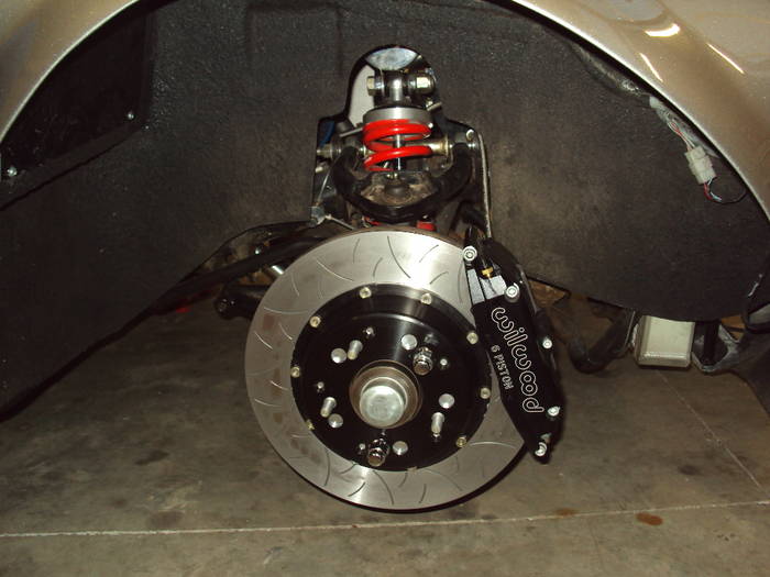

Chris L 01-11-2014 03:07 PM
Hey Fellas;
Whilst on the Python thing as my build came after Davids I can confirm mine came with the Girlock front calipers. However George's original spec brakes are long gone after a kit from Hoppers Stoppers which were fine. They also went after a while and I grabbed a set of Calipers (Wilwood 6 piston fronts) from Craig at AP and set about matching them up to a 330mm/32 ,hat set up for the front. Still use the original spindles that came with the car as I still have the Hoppers adapters over them to make it all work. That combined with the 4 pot Wilwoods on the back(Jag rear with outboard brake mounts) with a 315mm/32 rotor, I believe the brakes are the strongest part of my car and I'm extremely happy with the way they work. Mind you, it took me 3 goes to get it right !!
I flogged them at Shelbyfest last year and they were fantastic, consistent from start to finish and excellent feel, they didn't flinch............unlike the driver on a few occasions.
But as you guys know, its how you want to use your car, I always wanted something to do track days and fiddled around until I got it.
I must also mention Riverside Racing in Werribee. If you want some rotors and hats, go and see Gary there. He has a heap of stuff(new & second hand), his knowledge is unbelievable and he is great to deal with.Check out his Website to give yourself an idea of what he has and can do.
Chris L

Chris L 01-12-2014 02:49 PM
That's it Ross, Gary gets a lot of Nascar stuff in as well as V8 supercar gear. I know exactly what you mean and that's why it took me 3 goes of mucking around to get the car to a place I'm happy with. However I would have stayed with the second combo from Hoppers if I was keeping the 15" rims and not going to 17"s.
I got the rotors and hats from Garry and re-machined/modified PCD,s to suit.It helped as at the time I had my own machine shop and could stuff around with brackets and offsets until it was right. I too did not have a huge amount of money to spend so that's the way I did it, plus I wanted to learn as much as I could as well. Because I wasn't changing master cylinders or peddle assemblies, much calculation(Piston area had to stay as close as to what existed) was done to ensure the new combo would work on the existing spec stuff I had. Happy to say it all worked a treat and it was just a matter of getting the bias right after that.
I should also say that my Python does run a booster, not sure if David's does.
Chris L
Chris L 01-12-2014 04:32 PM
Having a crack at posting a pic, hope it works.
Regards
Chris L
http://http://www.clubcobra.com/phot...ke_Upgrade.jpg
Chris L 01-12-2014 04:44 PM
Try again.
Apologies
Chris L
http://www.clubcobra.com/photopost/d...ke_Upgrade.jpg
