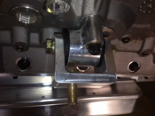

The Kirkham's are incredible if there is anything that can be made out of aluminium they will make it. The engine mounts bolted up.
http://www.clubcobra.com/photopost/data/500/image86.jpg[/url]

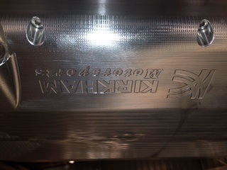

Full billet sump.
I love the way Kirkham carve their name into everything.
http://www.clubcobra.com/photopost/data/500/image89.jpg[/url]

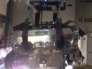

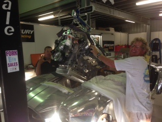

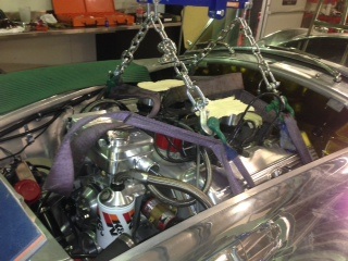

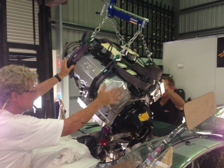

Nearly there this is half way in, started to get a bit scary here lucky we had a proper engine lift for the job even with that it took nearly an hour tilting and adjusting this thing to get it in. Even with the engine all the way back I still only had an 1/8 of an inch clearance on either side of the rocker covers at this point. Proper engine hoist $80.00 but priceless. Oh and a forklift made it easy too.
http://www.clubcobra.com/photopost/data/500/image93.jpg[/url]
Almost home just got to line up the engine mounts and were home, sorry could photograph that it was almost like being a gynaecologist.
http://www.clubcobra.com/photopost/data/500/image94.jpg[/url]
And all the way home, couldn't work out a better place to lift the engine from using the exhaust manifold seemed the logical place but I didn't realise the engine had such little clearance the straps were a pain to remove but got em with a bit of wiggling.

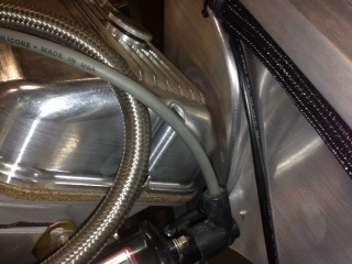

Just to prove how close it is.
http://www.clubcobra.com/photopost/data/500/image97.jpg[/url]
http://www.clubcobra.com/photopost/data/500/image96.jpg[/url]

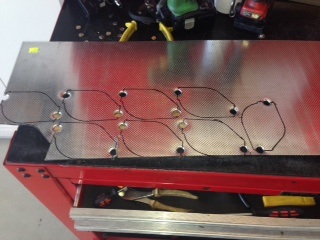

First was a run around to get oils and fluids for the big girl, also went to a mate at the exhaust shop for some gasket material I decided that making the gaskets was better then waiting for them to come from the USA at least that gave me an opportunity to get the exhaust on the car before finishing my holidays.
This is my exhaust gaskets all marked out and ready to cut.
http://www.clubcobra.com/photopost/d...0/image100.jpg[/url]

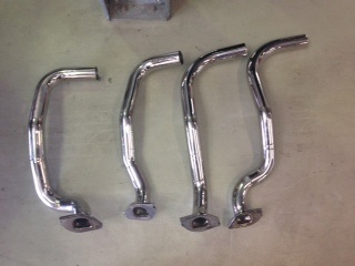

Pipes all laid out after sorting out left and right, would have been easier to look at the flanges Kirkham already had the left ones marked doh why do you always find those things after the fact.
http://www.clubcobra.com/photopost/d...0/image101.jpg[/url]

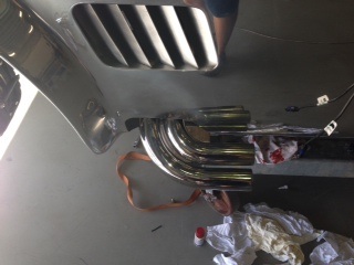

I decided to do the left side first seemed to be more room on this side so off we go. After fitting the first pipe I was wishing I had of just taken it to the exhaust shop and let them do it but by the 3rd pipe it was getting easier.
http://www.clubcobra.com/photopost/d...0/image104.jpg[/url]
http://www.clubcobra.com/photopost/d...0/image106.jpg[/url]
http://www.clubcobra.com/photopost/d...0/image102.jpg[/url]

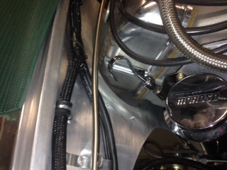

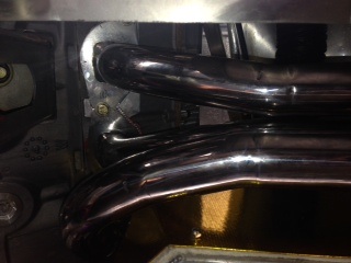

So with the left side header pipes done I started on the drivers side what a mission trying to get around the starter motor, after 5 minutes I decided I'd stop trying to cheat my self and take the inner guards out wow that's easier. Took me 2 hours to do the left side 1 hour to do the right,wish I had have pulled the inner guard on the left.
http://www.clubcobra.com/photopost/d...0/image107.jpg[/url]
