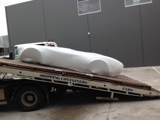

My Pace427 arrived last week. She left QLD at 1pm on a sunny Monday afternoon and arrived in cold wet Melbourne on Wednesday morning at 4:30am.
I can’t thank Craig and his team at Absolute Pace enough for storing my Kit in their showroom for close to 9 months while I waited for my workshop to be built. Then at the 11th hour I threw a huge spanner in the works by changing my engine choice. Craig’s response to the Engine change was, “No problem all part of the service”

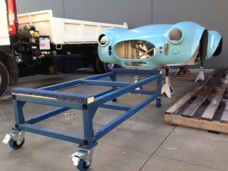

My build trolley came in very handy during the delivery and the unpacking stage. I made the top section of the trolley removable.
When we slid the crate off the Tilt truck we placed the bottom section of the trolley under the crate. This made moving the whole crate and kit very easy. Once in the carpark it took me about 2 – 3 hours in between the rain to unpack the Kit and move it off the packing crate and into my workshop.

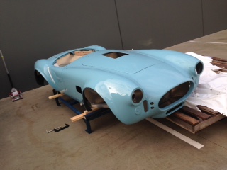

Moving the body and chassis off the crate was pretty easy because it’s so light. I slide it off the crate and on to the top section of my build trolley, then jacked it up on to Jack Stands before sliding the trolley under the body and chassis.
Now my Kit is all unpacked and waiting for me to start. If all goes to plan I should get the body off soon and start building iT : )

any chance of the measurements for the trolley you made i need to build mine and have it ready
cheers dean
albanycobra 05-20-2015 08:00 PM
Yeah some measurements would be good.
Love the gelcoat...always spins me out at the quality of the fibreglass...sorry Fellas but I have been the Victim of some really bad fibreglass in the past....

on my old car the fiberglass went from 2 mm thick to 19 mm thick i ground a lot out and added in other places that was one of the selling points for me on the pace was the quality of the body as i hate body work .

I'm smiling and looking forward to a long cold winter here in Melbourne and lots of shed time. Below is my build trolley, the base of this design was taken from the AP build manual and I changed a few things to suit my own needs and future projects.
I've used 50x50X5mm box tubing and 125mm Castor wheels. This trolley may not be suitable for other Cobra kits so check and measure first.
