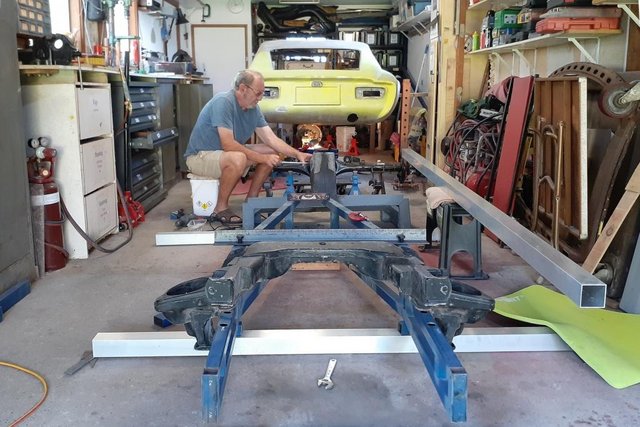

My Bolwell progress has been somewhere between slow and non-existent. I made the fatal mistake of actually repairing something on the house. Like going to replace a taillight globe and two weeks later the car is on a rotisserie, we similarly ended up with major house renovations. They're now completed but I just want to relax a bit.
