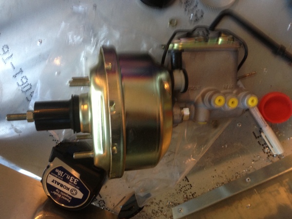

Hang on, are you saying you've got a single 1" cylinder that you then use for all of your brakes at the same time?
PSYCHO 08-15-2018 03:00 AM
Ok just picked up the car from the brake place and this is what they found the reseeded MC was still bypassing on the seals and one of the rear callipers had a small burr on the piston so that was bypassing and the clearance adjuster for preload on the booster was out by 4mm so in the end and $250 smackers it's a goer yay**) thanks to all of you great people for you advice and recommendations and Treeve look on page 2 of my gallery and there is a pic of the booster and MC once you se it you will go ahhhhh cheers everybody now just one more step and that's to silence the side pipes a bit more 6 more decibels to go
Regards and thanks to all Rob:JEKYLHYDE
