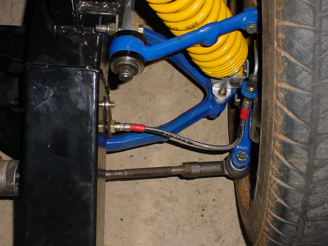

boxhead 01-23-2005 05:16 AM
Upper control arms
Hey there Churchy, here are 2 pics.
The first pic shows the wrong arms, I have been told these where used on both series 2 & 3.
The second pic shows the correct arms (not very good pic) you can see these arms are very straight as opposed to the first pic where you can see the arms tapper in.
http://www.clubcobra.com/photopost/d...64MVC-008S.JPG Wrong
http://www.clubcobra.com/photopost/d...rake_pipe3.JPG Correct
