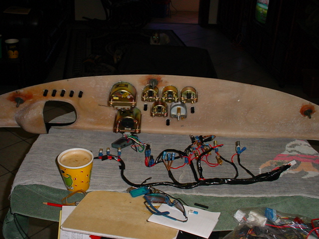

I have marked and drilled out the holes for my gauges and idiot lights.
Then on Saturday night I made a wiring harness for the gauges and lights (much to my wifes displeasure this was done on the dining table), I have made the harness and used 1 single 22 pin connector so that I can unplug 1 loom and remove or refit entire dash panel.
I am sure I will add some switches to the dash so I will make a second loom with this in mind.
Sunday morning I then disassembled it all and prepped the dash for paint, After filling in imperfections, sanding then spraying filler and more sanding I grabbed my pressure pack of new black wrinkle finish paint, warmed up the panel under heat lamps only to find the new paint wont come out of the can.
So it looks like a trip back to supercheap to swap the can.
Here are some pics for those that are interested.
http://www.clubcobra.com/photopost/d...a_dash_003.jpg
http://www.clubcobra.com/photopost/d...a_dash_004.jpg

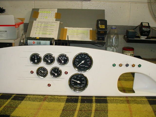

boxhead 08-14-2005 05:53 AM
Well after doing some more garden work and a couple of tip runs I got back into the shed.
The first thing I did was push the car out and mount 4 more fluro lights so that it isnt like a dark little world in there now.
I bought some heat lamps from supercheap and got the panel nice and warm then proceded to paint the dash.
It has come out alittle blotchy and the wrinkle finish is not very even so I may sand it all back and do it again yet.
I fitted all the gauges back to the panel.
http://www.clubcobra.com/photopost/d...t_2005_006.jpg
Then I refitted all the wiring loom I made up.
http://www.clubcobra.com/photopost/d...t_2005_001.jpg

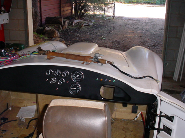

After this it was a quick trip out to the shed and refit the dash.
http://www.clubcobra.com/photopost/d...t_2005_009.jpg
Now I have a question for the Classic guys that have there dash in and also have steering colomn in.
When you mounted your dash did you mount it so the rear of the panel sits flush against the mounting points or did you do as I have done and glassed in 3 bolts to mount the dash?
I ask this as now that I have done it I didnt think about the colomn.
It appears that I wont be able to use the original Barina shroud, is this normal that you need to make a shroud? or modify the original one?

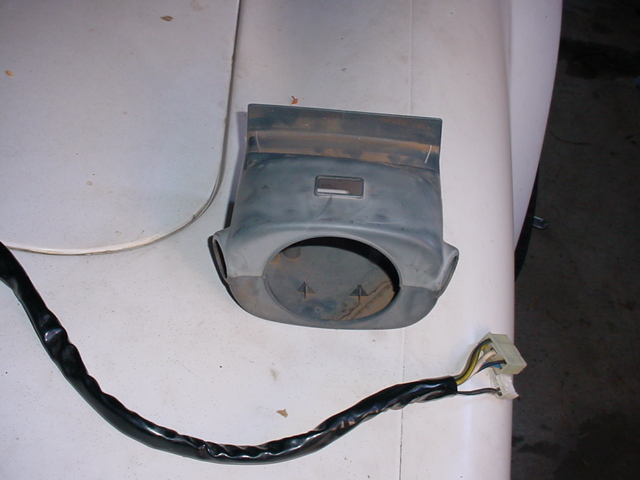

Here is a pic of the Barina shroud I got with the colomn.
http://www.clubcobra.com/photopost/d...t_2005_012.jpg

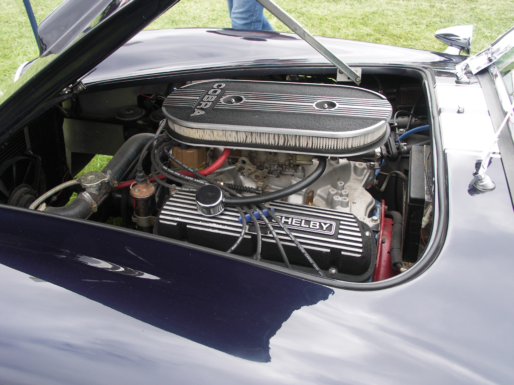

To get a good wrinkle finish the paint has to go on with a thick and even coat.
The paint has to be thick or it won't wrinkle.
I did my air cleaner and rocker covers with it.
http://www.clubcobra.com/photopost/d...Engine_bay.jpg
Bryan Wilson

You can use the regular Barina column shroud, you just have to trim that back lip off it that back lip off it that stands up at 90 degrees. Spray it with the wringkle finish paint to and it'll come up a treat.
The dash panel itself needs a bit of surgery to clear the column mounts and the key mechanism. you will need to trim a bit of the fiberglass inside that pocket where the column shrouds sits into.

Here's a pic that shows the dash with the suzuki shroud on the column.
http://www.clubcobra.com/photopost/d...Red_Dash_1.JPG
