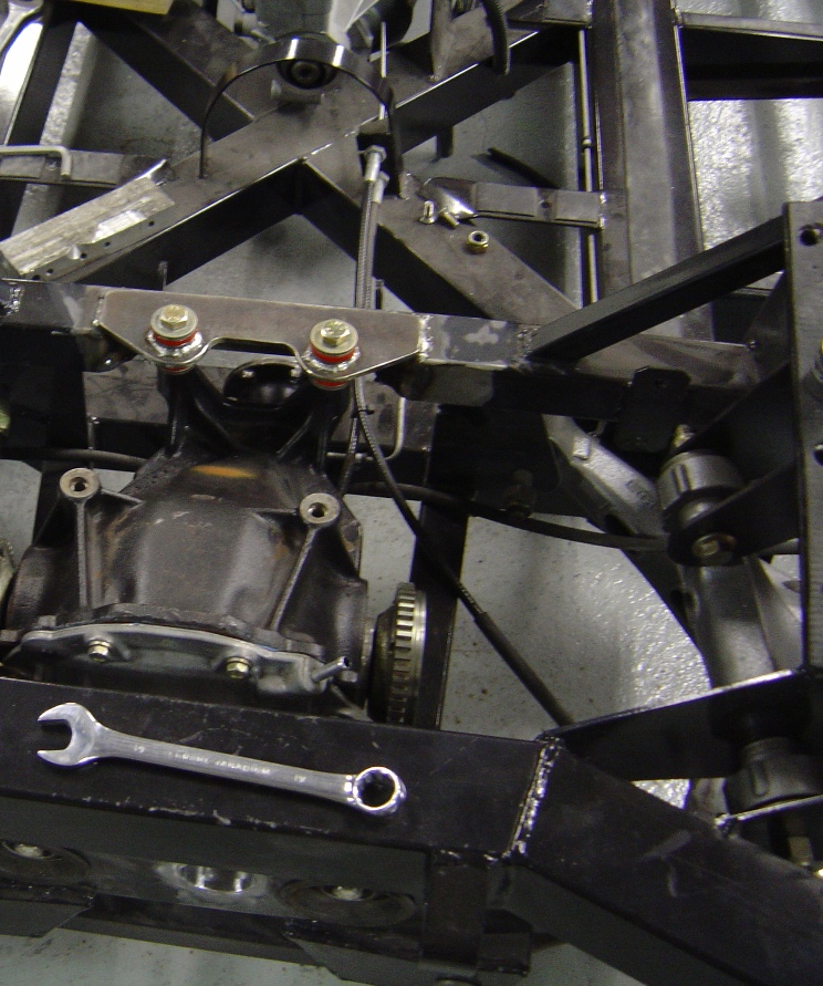

Wheres the best place to rout your handbrake cables? remember a picture says a thousand words. :D
Tenrocca 03-02-2006 03:03 AM
Anyone...(I know its a stupid question and I should be able to work it out myself).... Especially the left one, over the diff? :)

Don't know if it's the best way but this is how I've run mine. Sorry it's not a better picture but it's the only one I could find that shows them.
The cables run inder the diff and are cable tied together as just near the pinion to keep them away from the flange. I've also used a couple of cable ties to secure them to the frame rails under the diff so they are kept away from the axles.
Hope this helps
