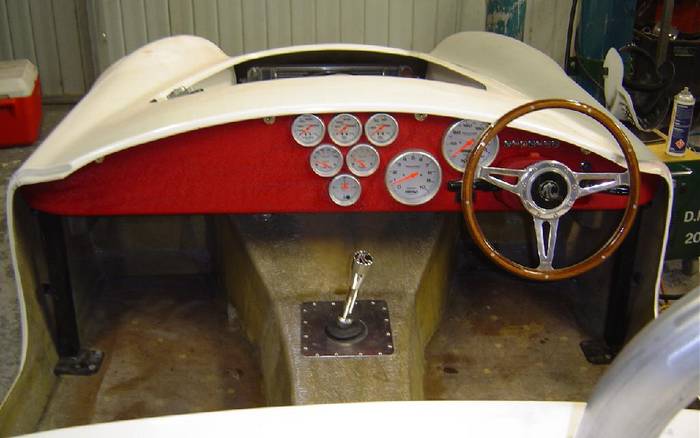

I would love to know too.
Perhaps the measurement back from the crease in the tunnel would be best.
I was going to work off this pic of Mike's.
http://www.clubcobra.com/photopost/d...Red_Dash_2.JPG
Ben

Thanks guys from the crease would be good.

The center of my gear stick appears 700mm forward from the top of the tunnel where it meets the rear bulkhead. The hole is also pretty much in the center of the tunnel, maybe off to the left by half an inch.
The shift location on the Mal Wood box may be a little different to my conversion but it'll be pretty close i.e. within an inch or so.
