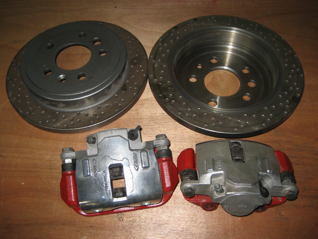

Due to a rear brake component upgrade (I couldn't help myself) My AU2 XR8 IRS rear discs and calipers are surplus to requirements.
The discs are brand new never used, I've drilled them and chamfered the holes.
The calipers are rebuilt, polished, painted and come with new pads.
I'm asking $150 the lot as I'm just trying to recover some of the $$$ I spent on the new discs.

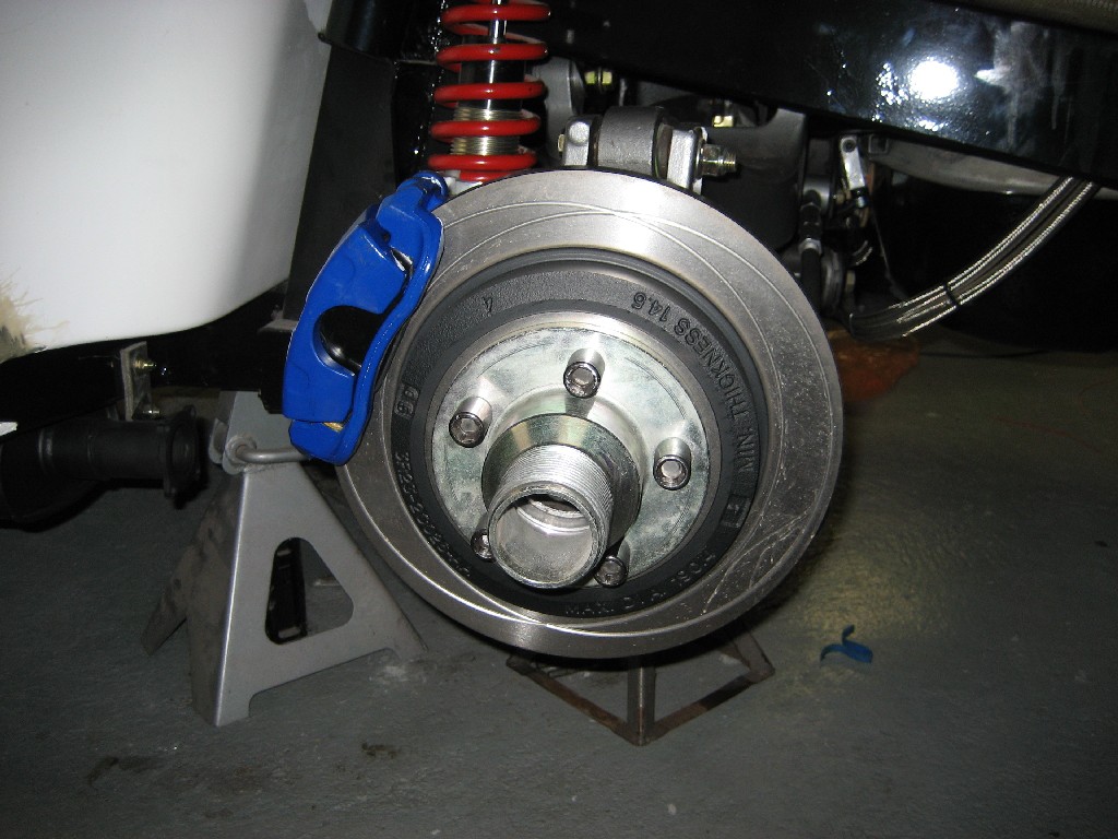

Mike here is a pic of my special order dba rear territory discs

Default Territory discs
HI Craig,
Good looking discs, what do you mean by "special order"?
I was looking at getting a slotted set.

Hi Phil
DBA dont list a sloted & cross drilled rear rotor for the Territory but a friend of mine manufactures components for them so he organised a one off set through his cantact at DBA.
