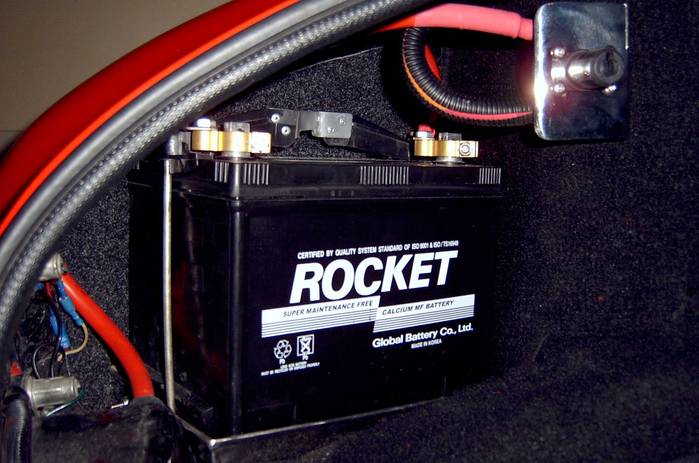

Put the battery in the boot
Stephen,
Put the battery in the boot. Put the effort in now you wont regret the decision.
I cooked two bateries under the hood. I put the battery in the boot last year and wished I had done it a couple of years ago. My engine temp dropped heaps due to the air flow also.
I have bought a Rocket 550 CCA battery (it is a standard size) for less than a standard commercial battery. It turns my old Clevo easily, even when she doesn't want to start. Here's some pics.
http://www.clubcobra.com/photopost/d..._Battery_a.JPG
http://www.clubcobra.com/photopost/d...in_boot_1a.JPG
TC
Aussie Mike 05-15-2007 06:52 AM
Very tidy install Tony. You should be proud of that.

I have already made the boot location decision but I was given a perfectly good exide battery from an SS ute so I want to try and make that fit to save the pennies for now. What did the rocket battery cost? and is it one of those gel type batteries?
Notice the battery disconnect key in the boot, how does that go for race events? Is it a case that you simply must leave your boot unlocked when racing?

Tony Cram 05-15-2007 09:07 PM
Switch for Racing?
Stephen,
I have another Isolation switch in the engine bay just in case. Sorry no photo's of this in my gallery, I will try and do one tomorrow.
Rocket battery I think was about $90 - $100 (I got it pretty much wholesale), and I am pretty sure it is just a sealed type but it does have an condition indicator panel on top. The selling point for the battery was the CCA of 550amps most batteries of this size are 450 or less. It comes in handy when I haven't run the car for a while and takes a few more turns to get her running. This is probably not as much an issue with the fuel injected engine you will be running. So far the battery has been excellent. There are plenty of other options but they usually mean more $$$
